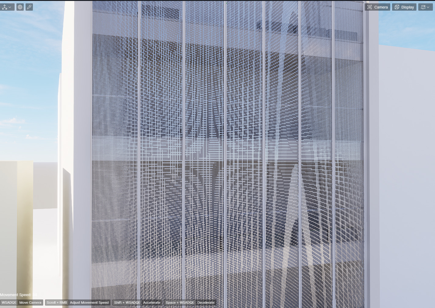

When rendering wire mesh or grid patterns (including fabric), the surface often fluctuates constantly. This is a significant distraction. Is this a problem with my computer’s specifications or with the program’s settings?

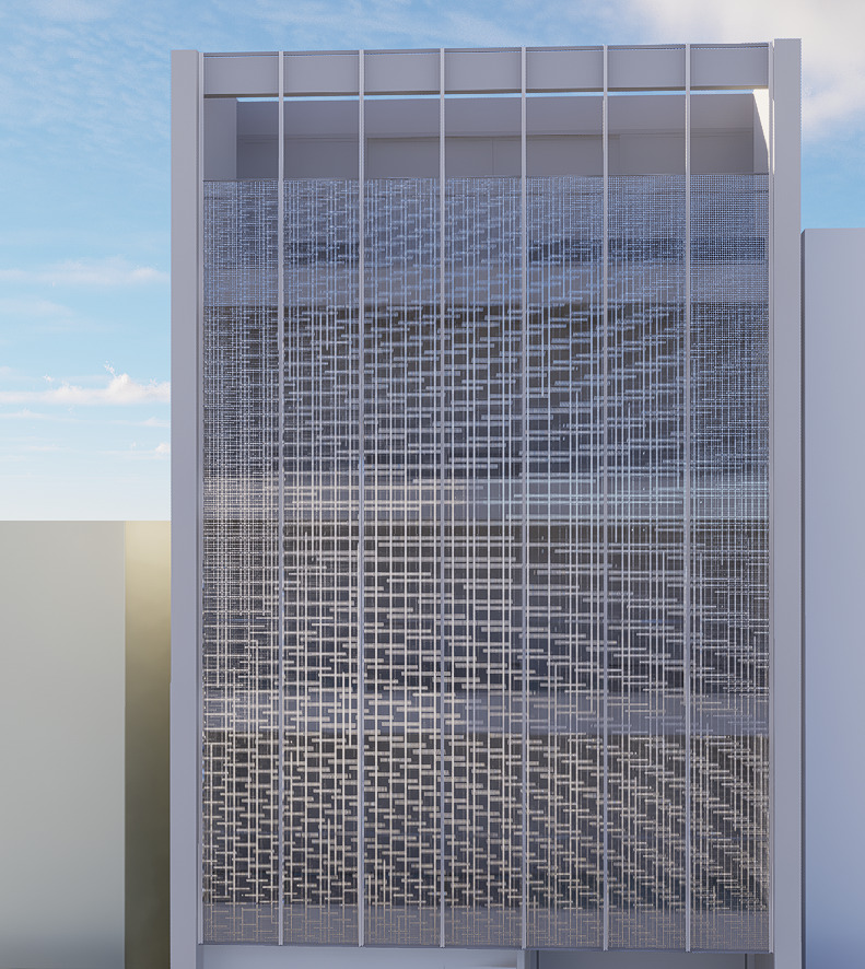

Things like the image below keep flickering and disrupting my work.
Hi @cyh21534
- Check if there are overlapping surfaces in your 3d Model
You may also check the following:
- Enable/Disable SuperResolution
- Enable/Disable FPS Booster or FSR
- Enable/Disable LOD
