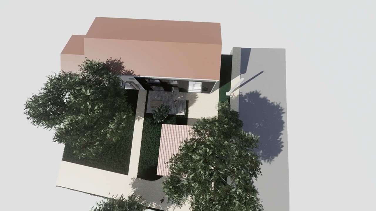

Does anyone know how to stop the edges of the glass and window glass flickering?
I have tried everything I can think of.
Thanks
Thanks

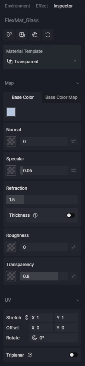

Please screenshot your glass material parameters.

Below screenshot of my glass mat

Set same material parameters
Same result…
trying with Thickness set to “on” in material parameters…
Thickness set to 2 or 5
No changes
Glass is still flickering
supersampling on or of no change

Hi mate, it seems a bug, can you show me the glass material’s parameters panel?
Also, if possible, please send the scene file folder to support@d5techs.com, we will look into this problem asap. (Please make sure your video driver is updated, and I think this problem does not happen to other files on your computer, right?)
