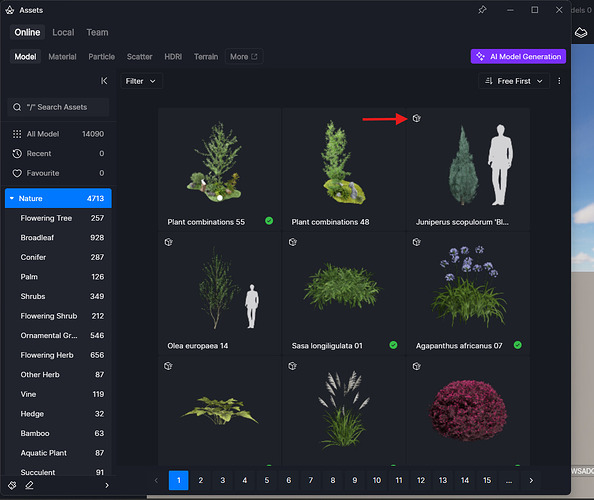

Thanks for reaching out. The Dynamic Mode (for wind, clouds, and environmental animation) typically requires animated objects or keyframes in the timeline.
If everything in the scene is static, the option may remain disabled. Do you have any animated objects (plants, particles, paths) with keyframes?
