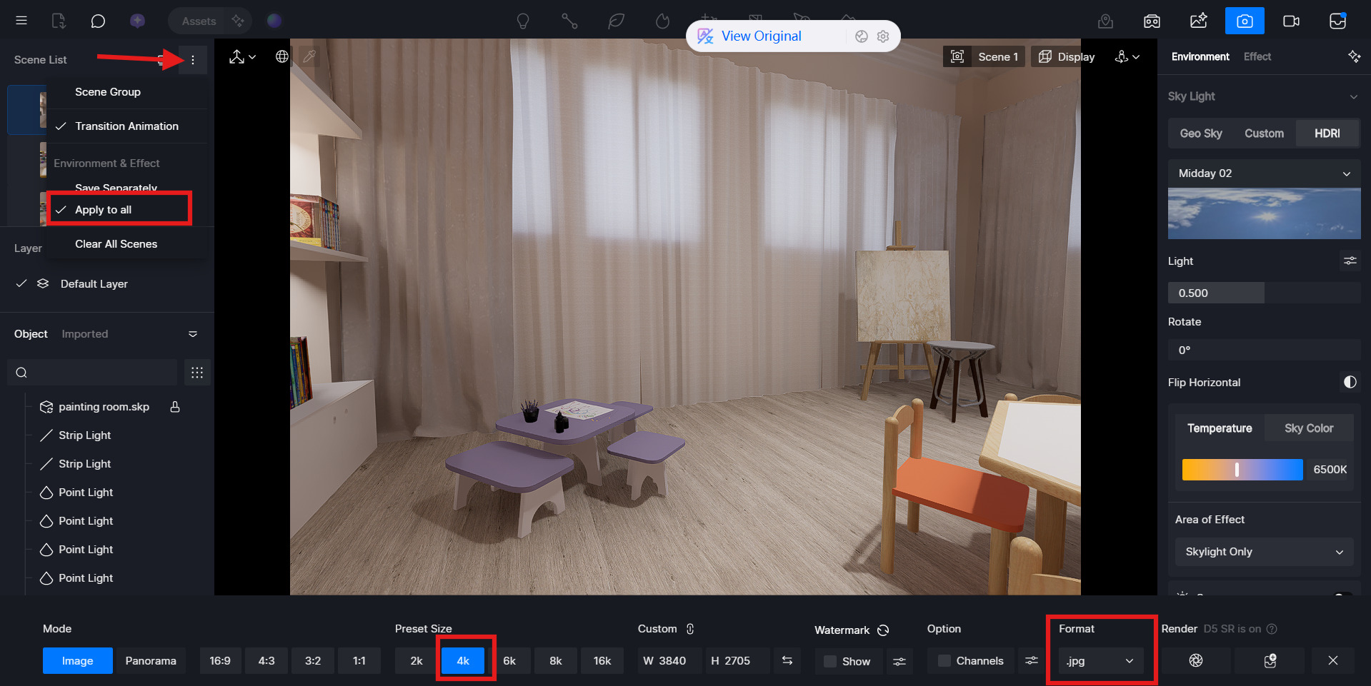

Currently, D5 Render doesn’t have a global “save default image settings” option that automatically applies to all new scenes.
However, there are a couple of workarounds you can try:
  • In Render mode, add your first scene and set the preferred format and resolution. Then click “Apply to All” before adding more scenes — the settings should carry over from the first scene.

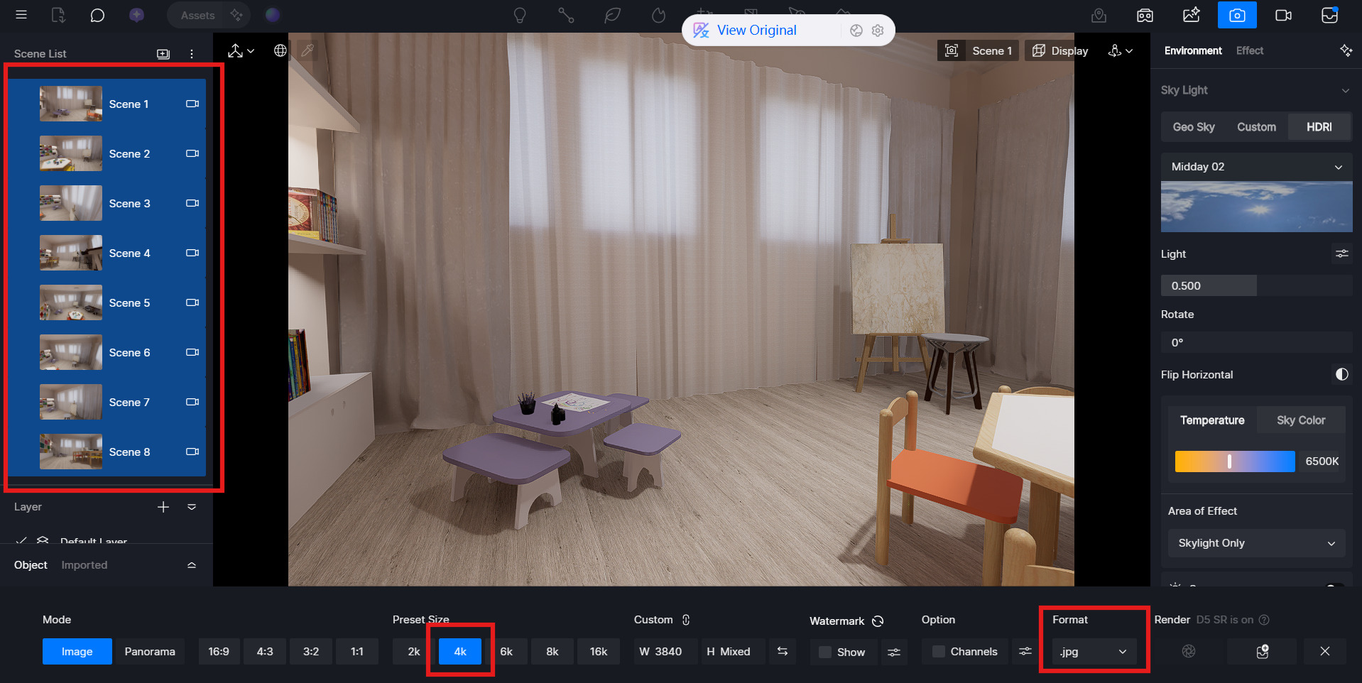

  • You can also select multiple scenes at once by Shift + right-clicking the scenes, then set the format and resolution for all of them simultaneously.
Wow, I didn’t know we could do this. Just one question about the first method you showed, if I click ‘Apply to All’, will it apply all the settings to every scene? Usually, I have different sunlight directions in each scene. But the second method works great!!
Thank you so much!!
Hi @krashnajadeja0000
Glad to hear the second method works great for you. :blush: As far as I know, clicking “Apply to All” should only apply the render settings across all scenes, so your individual sunlight directions should remain unchanged.
You can also try the first method on your end just to confirm. That quick test will help verify how it behaves in your specific project, and sharing the result could help other users who might run into the same situation.
