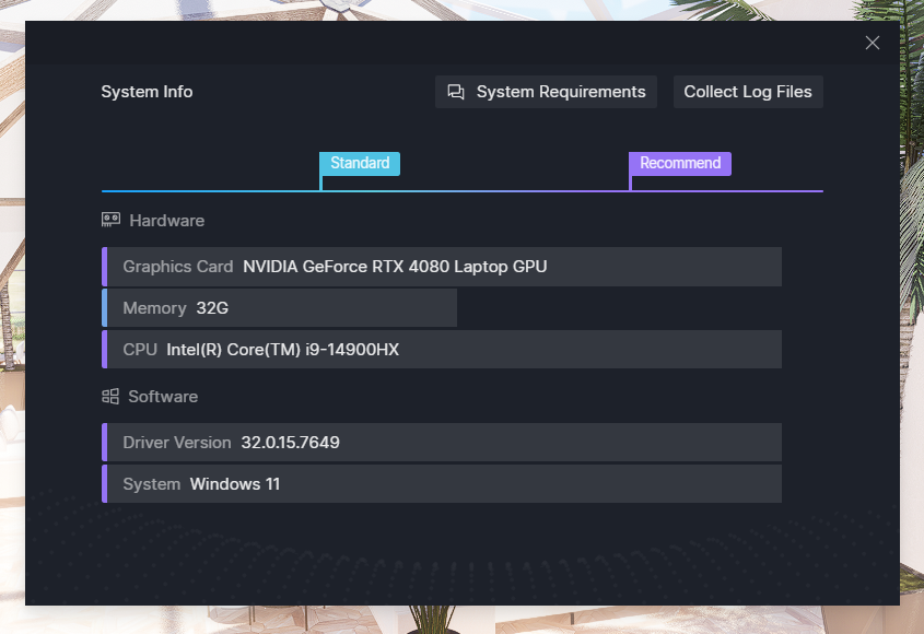

I’m currently working on a laptop, and despite having the specs shown in the attached image, I’m experiencing significant lag while using D5. It’s been quite frustrating, and although I’ve tried various optimization tips I found online (which helped a bit), the performance is still not ideal.
If you happen to know of any specific settings or adjustments that could help improve performance on a laptop, I would greatly appreciate your advice. I’m also wondering whether this level of lag is to be expected on laptops compared to desktops, or if there might be an issue with my device in particular.

D5 is reliant on your GPU, and dealing with complex projects with large file sizes will depend on your GPU Memory. Currently, I’m only using a laptop with 8GB VRAM, and lag is expected most especially in files that are quite heavy.

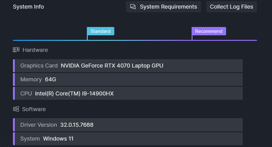

I can’t see your video, I might have the same problem and I would like to post my video but it seems like I can’t upload it here. What am I missing?

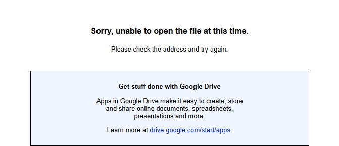

https://drive.google.com/file/d/1ry8hzR4GNIY9fSWpCL_su8Ega8FZ_XS0/vusp=sharing
I don’t know if you can see it now
Hi @Ellys2981
I cant open :disappointed_relieved:, try modifying the permission settings.

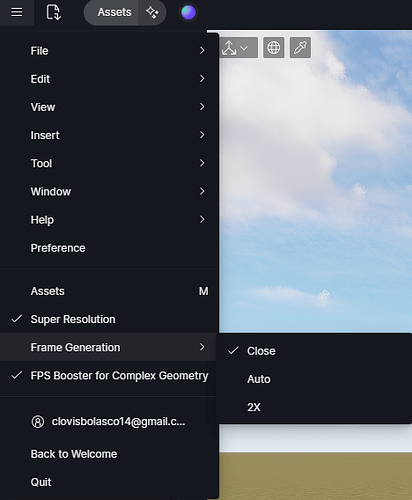

I saw your video. Please try to disable DLSS/Frame Generation, set it to “Close.”, and see if there are any differences.
Hi, it seems much better than before, but still …not perfect. Maybe because the model is quite large
Hi @Ellys2981
It should remove the jittery or watery effect that you experienced which is abnormal, it was caused by DLSS, and will be fixed in subsequent release.
  • Additionally check your VRAM too, if it close to exceeding your device’s VRAM then lagging should be expected
