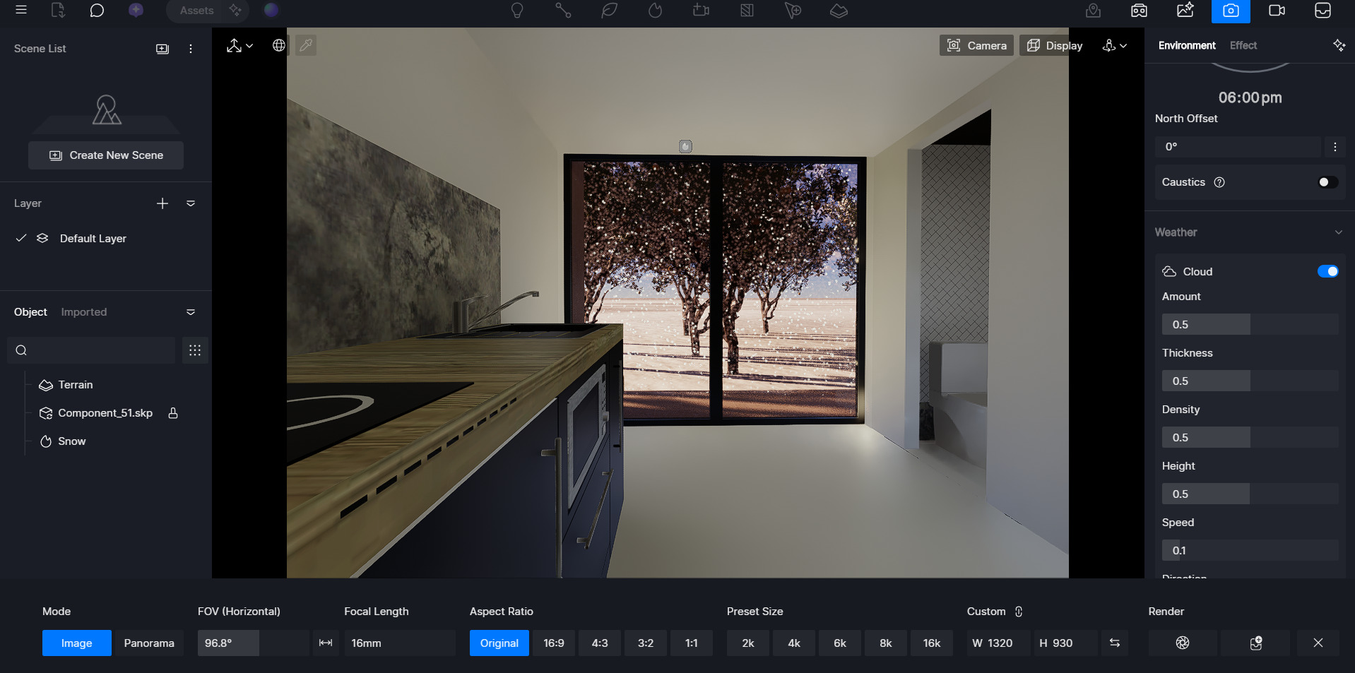

Why doesn't it snow far away from the point of view?
I’m trying to render a video of a snowy scene, but I can only see it coming down from a nearby window, and it’s not coming down from a distance.
It’s the same when i turn off the Level of Detail. What’s the problem?
I’m using the free version now.

Thank you for your answer.
I have attached the image.
The same phenomenon occurs not only in video rendering, but also in image rendering and preview.
Clip 1(1).zip (3.1 MB)
I’m attaching a 1.5 second video as a ZIP file with a 4MB capacity limit. Please help

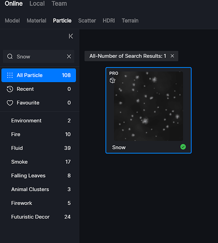

Hi @dadu729
We’ve reviewed this case and found that it is actually a known issue. As a workaround, please try placing the snow particle assets (Online Asset Library > Particle) outside the window.
Let me know it makes a difference. Thank you!
Thanks for your help. I’ll work it out your way
