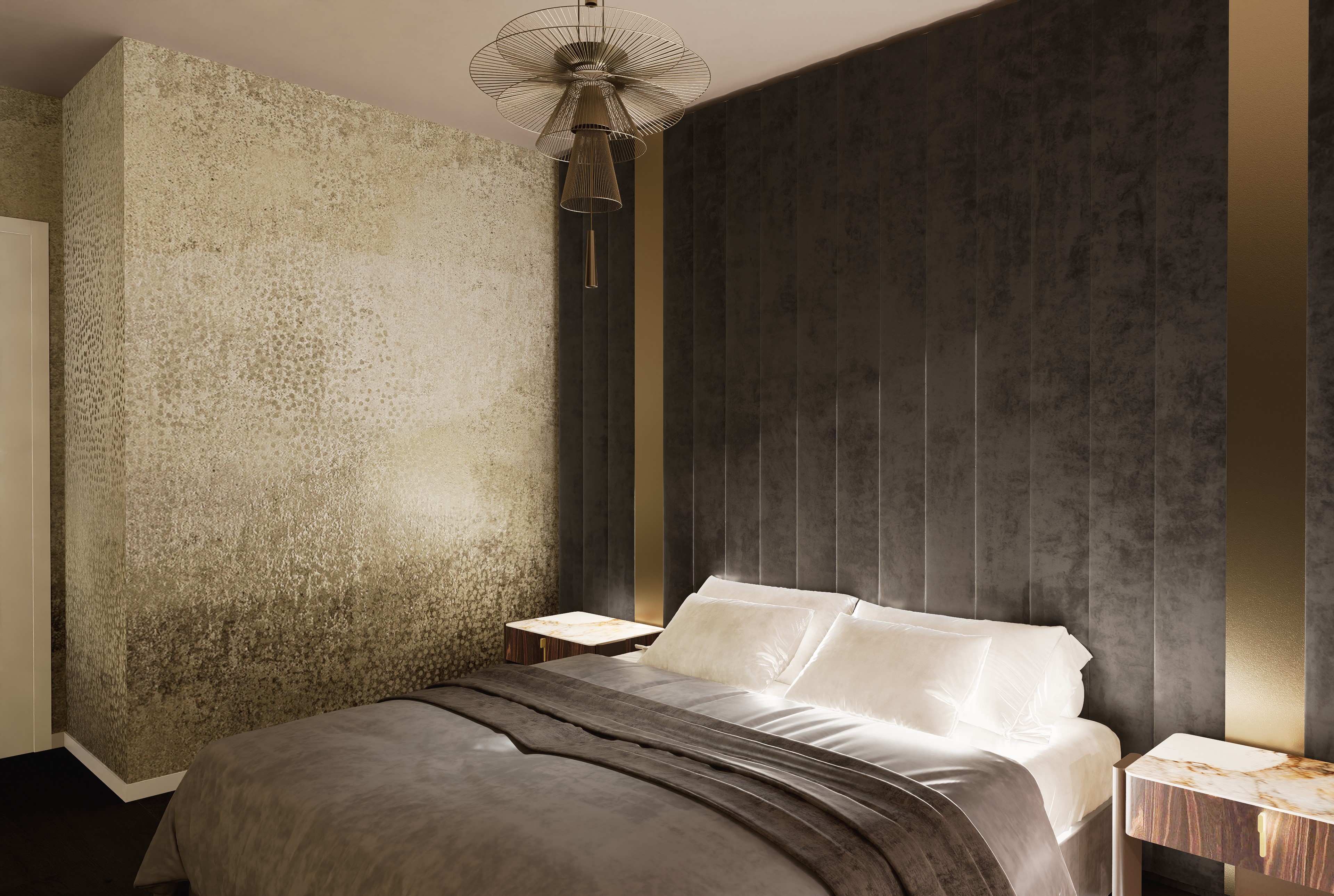

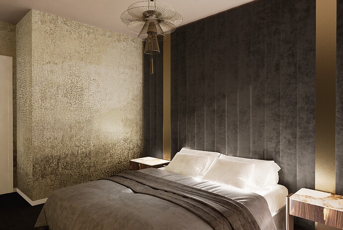

Hello lads,
Can I ask you for help, I have this problem.
The render is still in the draft stage, but I often get these terrible white lines. and also these emissions of light.

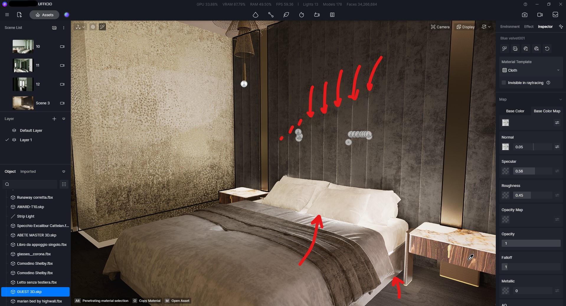

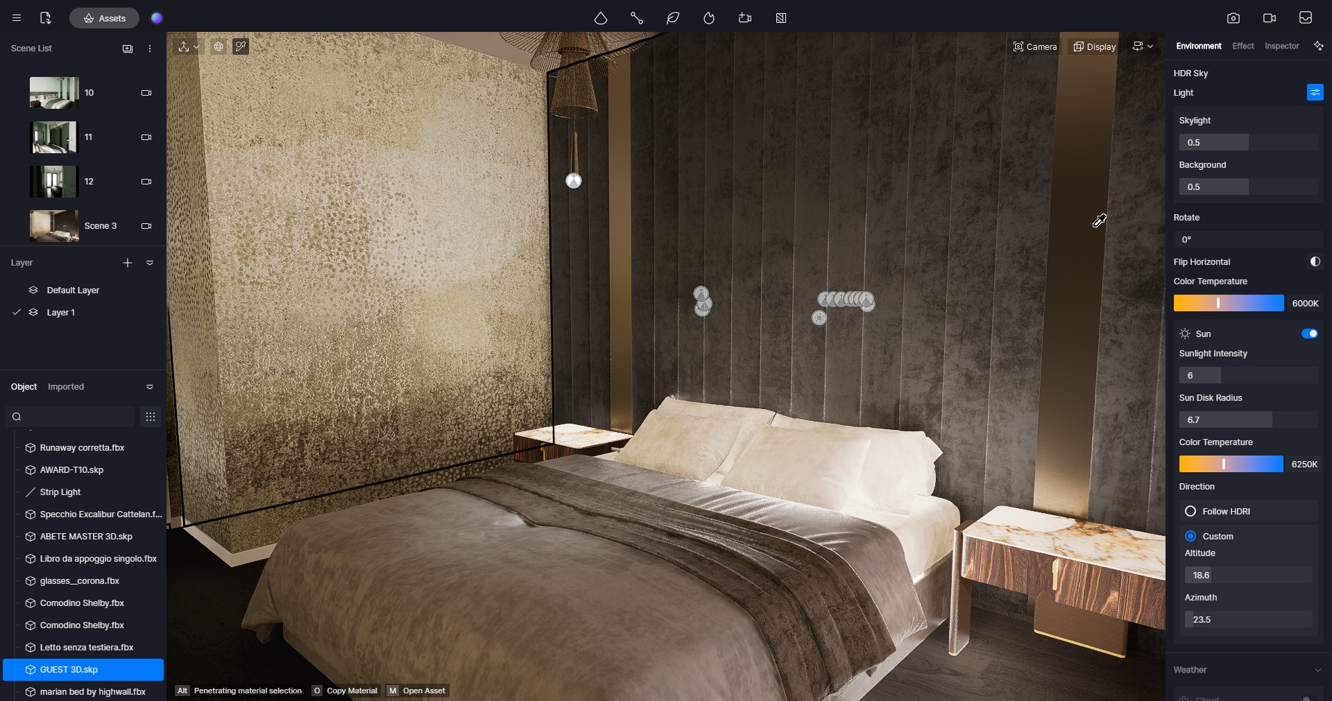

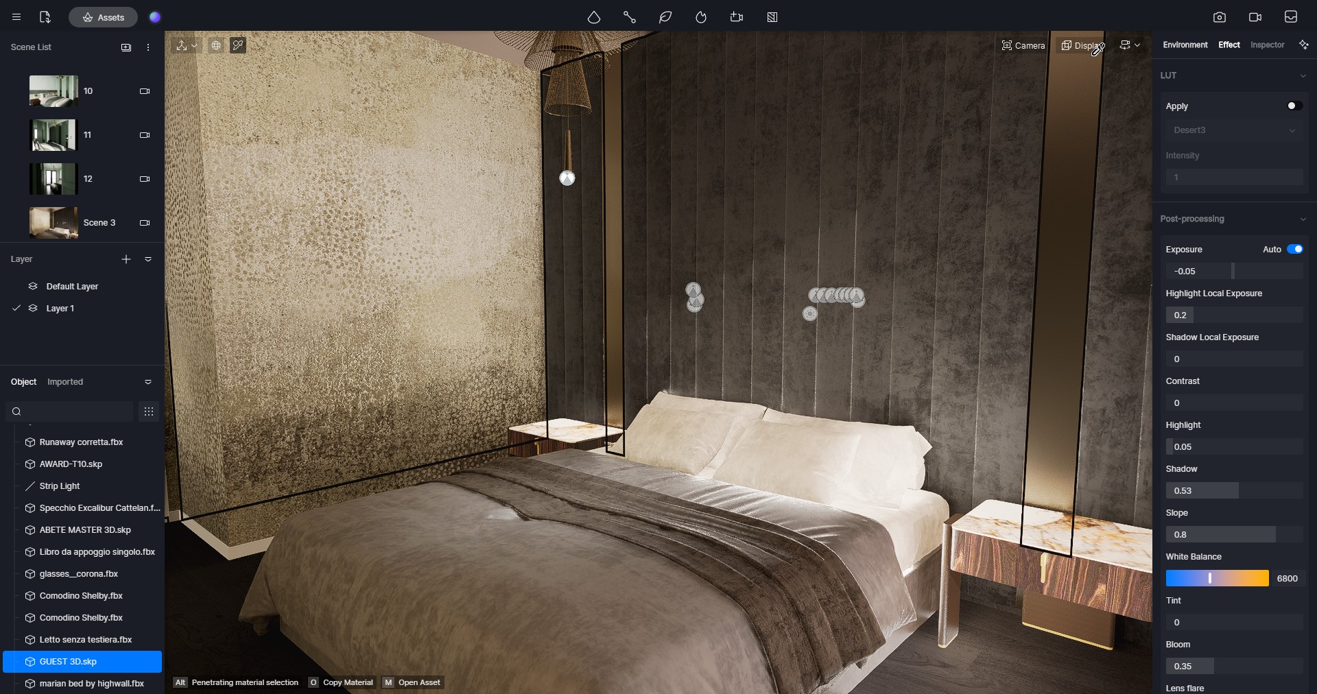

I also attach the screen of the material and the general light.
Thank you very much
Hi, Maybe the light you put on is too strong, you have to remove the reflection on the material that creates the light from the light, then you have to lower the power then you have to put less reflection on the materials and it’s a bit rough, and manage it better AO lower it. the same thing with the fabric of the cushions, by the way if you don’t want to lower the power then give it a color that goes towards dark i.e. if it’s a warm light give it less orange more towards dark bronze.
It can be seen that the fabric has too much specularity to be at least 0.05
Hello. I suggest you can lower the specular. If this issue continues to happen after adjusting the specular, you can try turning off SR and then rendering again and checking it.
