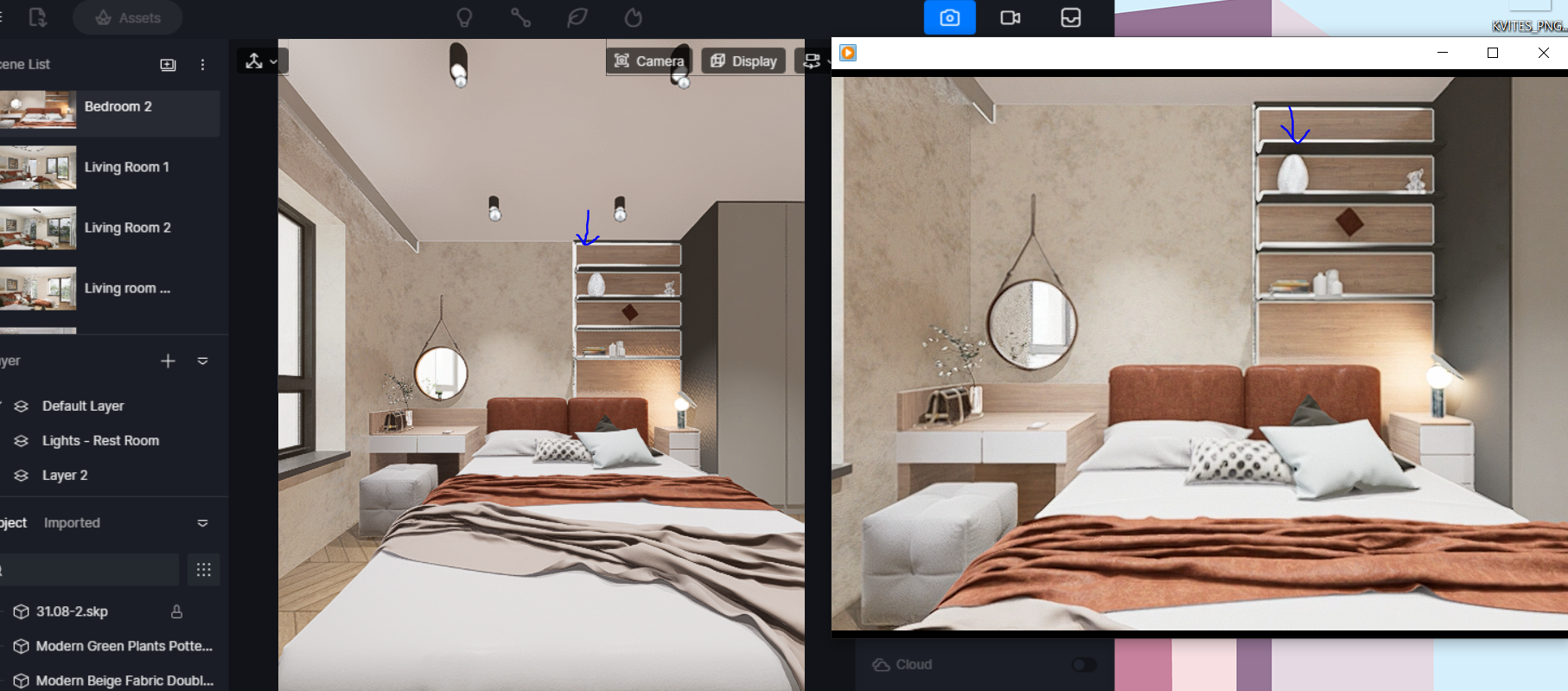

Hello there! I have encountered a problem where when I navigate around a scene, everything is ok. But when I stop, after couple of seconds
this happens: Appears a white line around edges (like a selection but nothing is selected)

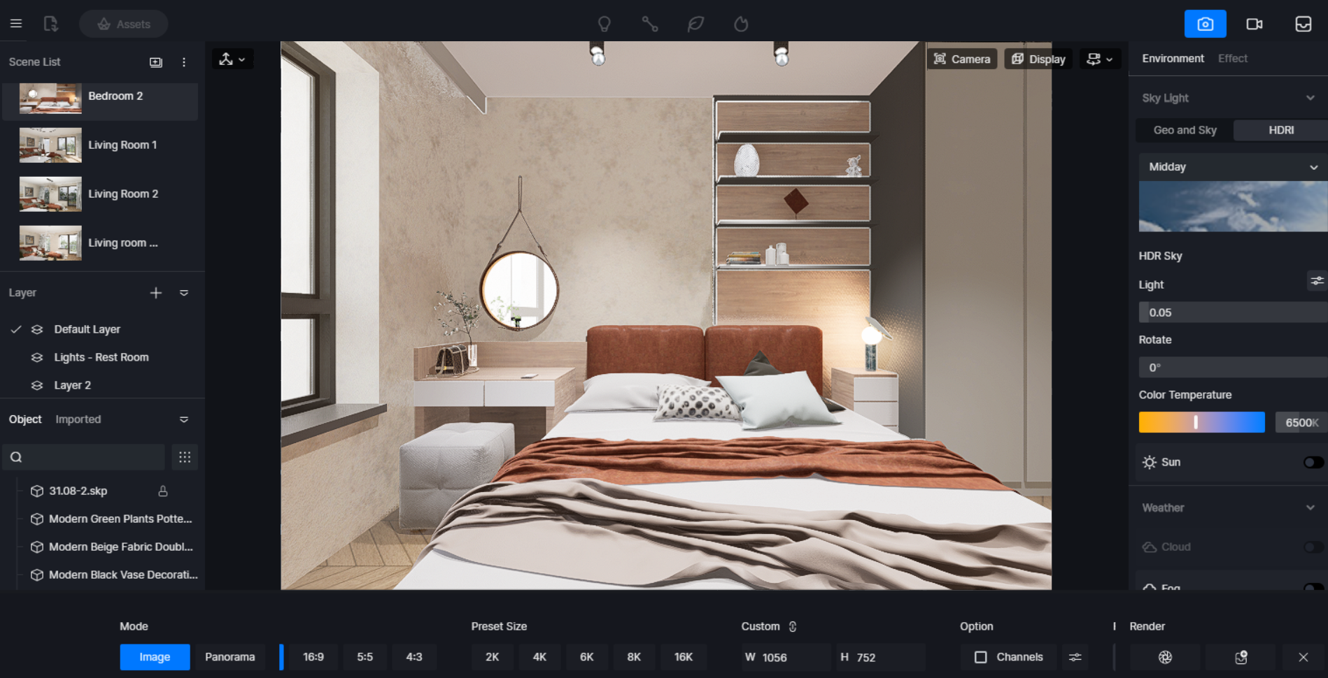

When i a render a photo, it dissapears, but the main proble is that it appears on the video.
Have anyone had similar issue? Thanks for any help.
Hello, did you turn on Round corner effect for this material with a high value?
Also, from the screenshot, I guess it is a known bug of reflection issue. Please check whether there is an object in this scene file that is too fay away from the origin point, if yes, delete it or move it closer to 0,0,0.
For further troubleshooting, please compress this scene file and send it to support@d5techs.com. In this way, we can narrow down the issue cause faster, thanks!
Hey Oliver, thanks for the reply. You were right as there was an item far away as a matter of fact, along with the bug of the reflection (there were a metallicness applied for a material, so it did odd effect). Cheers!
Ok, glad to hear that the problem is resolved. We will fix this bug in 2.4.
