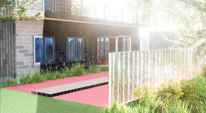

When i make render picture, there is a vertical line
I did update, and it kept making the line
Hi @allice9122
Vertical lines in renders are often caused by the model being positioned far from the origin (0,0,0). What is your modelling software? Is your model far from the origin in the modelling software or in D5?
Please try to move the model closer to the origin, the issue should be resolved. :blush:
