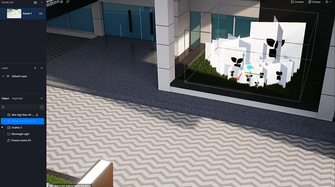

no!..i have RTX 3080 Ti … it works well …any other benefits working at cloud ? how to do it ?

i checked everything …nothing works … its happening only in case of Group vegetation

it worked … I changed the asset storage location to another Drive … Now it’s working ! ! !
