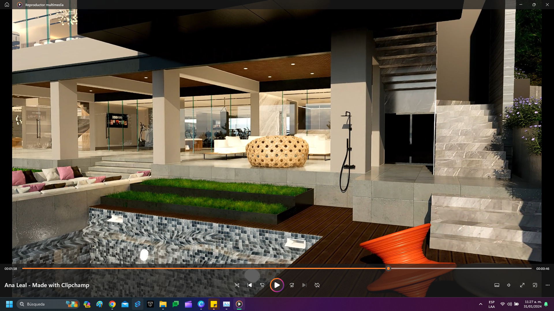

I first rendered a video from a backyard garden but just could noticed after rendering that specifically in an area of the garden with 3D grass apllied, there was some flickering of light, like it was moving, but there is no wind or anything like that aplied, then i thought it could be due caustics of the pool, so I removed the effect from the material, also i checked taht the lighting and enviriomental configurations would be aplied the same between scenes, but still after rendering it happens, any idea to solve it? Im attaching a recording of the issue

You can see the problems in this areas
THE BAMBOO PLANTS IN THE SECOND FLOOR
TE GRASS IN THE GARDEN POT OVER THE POOL

Hi! I have checked your video. May I ask if the lawn next to the pool is still flickering after you removed the caustics of the pool? From your video, it does look like the grass was affected by the caustics. For the rest of the flickering in your video, I would like to ask about the resolution of your rendered video. If the objects in the scene are less than a pixel in the video, flickering may occur. So you can try to increase the resolution of your video. Also, you can check if your model is too far from the origin, which may cause flickering.
YES CAUSTIC EFECT IS OFF BOTH IN LIGHTS AND POOL,
THE RESOLUTION OF THE VIDEO IS 1080P

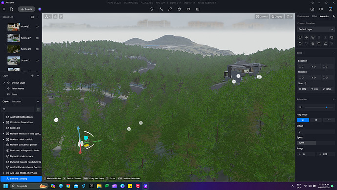

HERE IS THE ORIGIN MARKED, SO ITS KIND OF CLOSE NOT THAT FAR
I suggest you try a higher resolution render, like 2K or 4K. Also, I noticed you use a lot of 3D trees, I think you could also try replacing the distant trees with textures.
