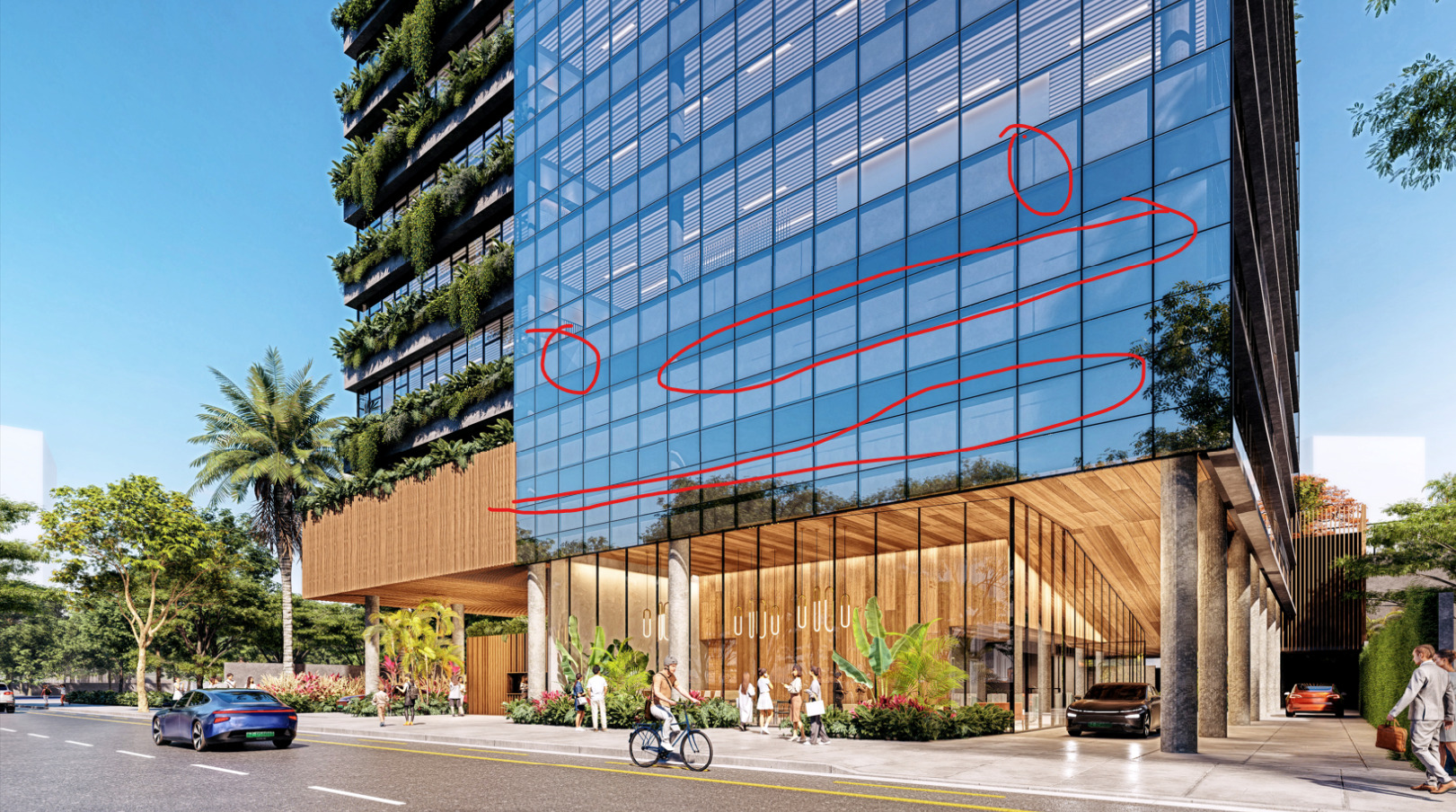

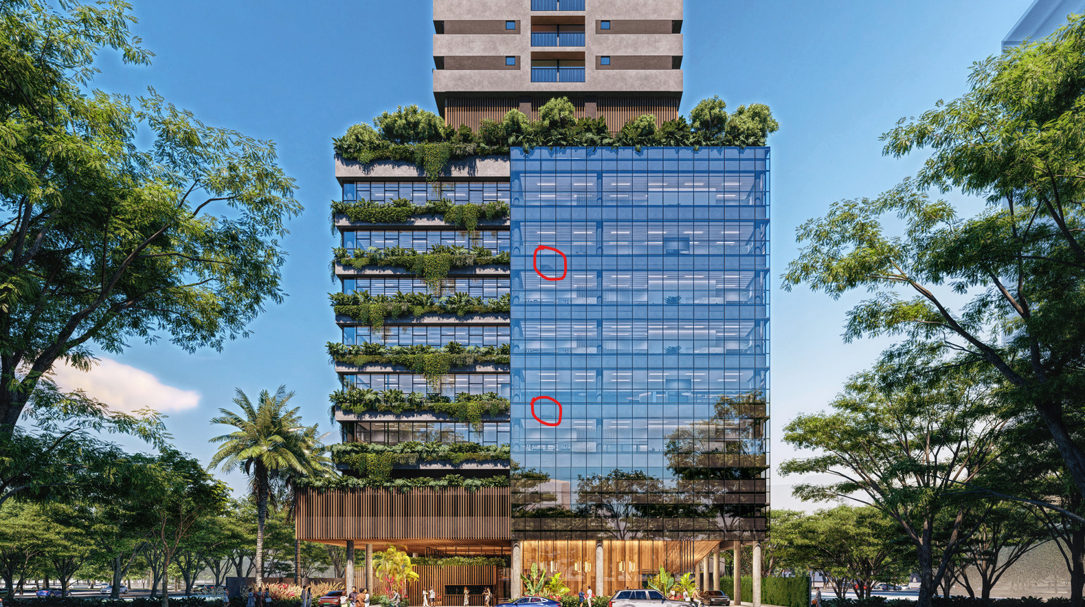

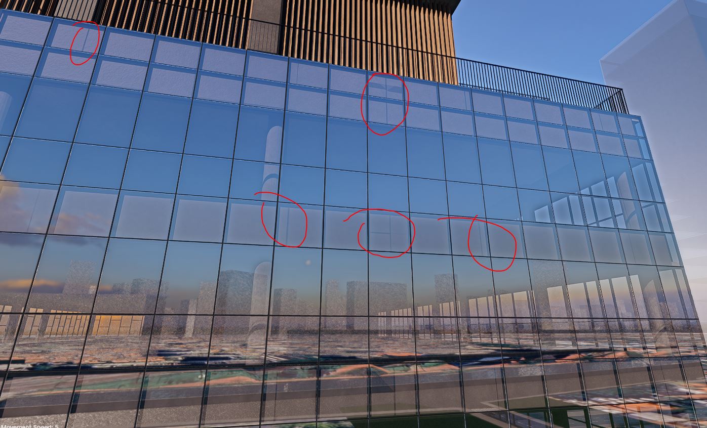

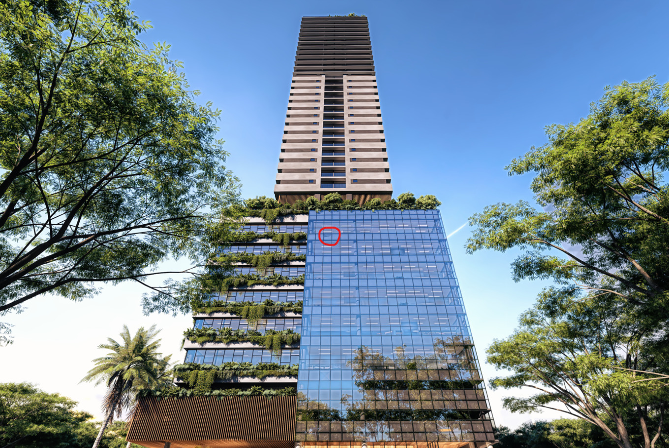

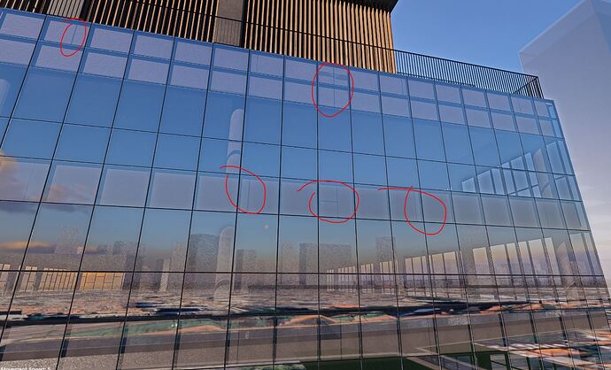

I have a problem where strange shadows are appearing behind the glass, in the shadow box. I’ve already checked the glass mesh and it’s not coplanar with the shadow box, I’ve tried adding thickness, removing thickness, deleting the back face, remodeling it in several different ways in 3dsmax. I’ve already smoothed the mesh, etc., but I can’t solve it. Changing the glass material also doesn’t solve the problem, any material I put there remains the same. When I delete the glass mesh, the shadow disappears.
glass with reflections
no reflection glass
you can see the glass divisions
hidden glass

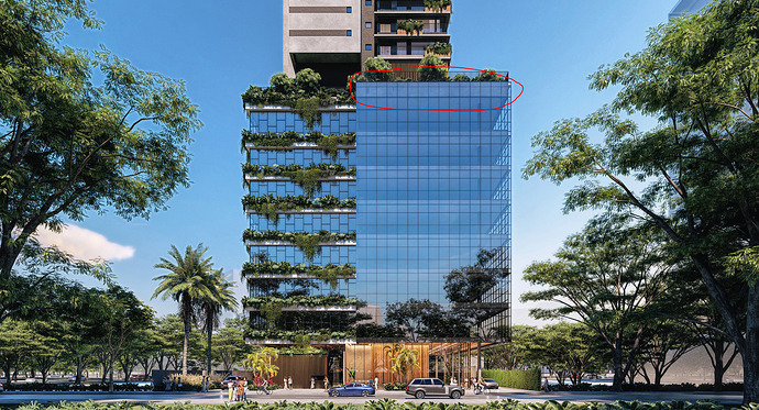

the scenes where this bug appears the most are these takes ( video)
TAKE_07_ok
TAKE_ELEV_POSTERIOR
TAKE_AEREA_GIGANTE

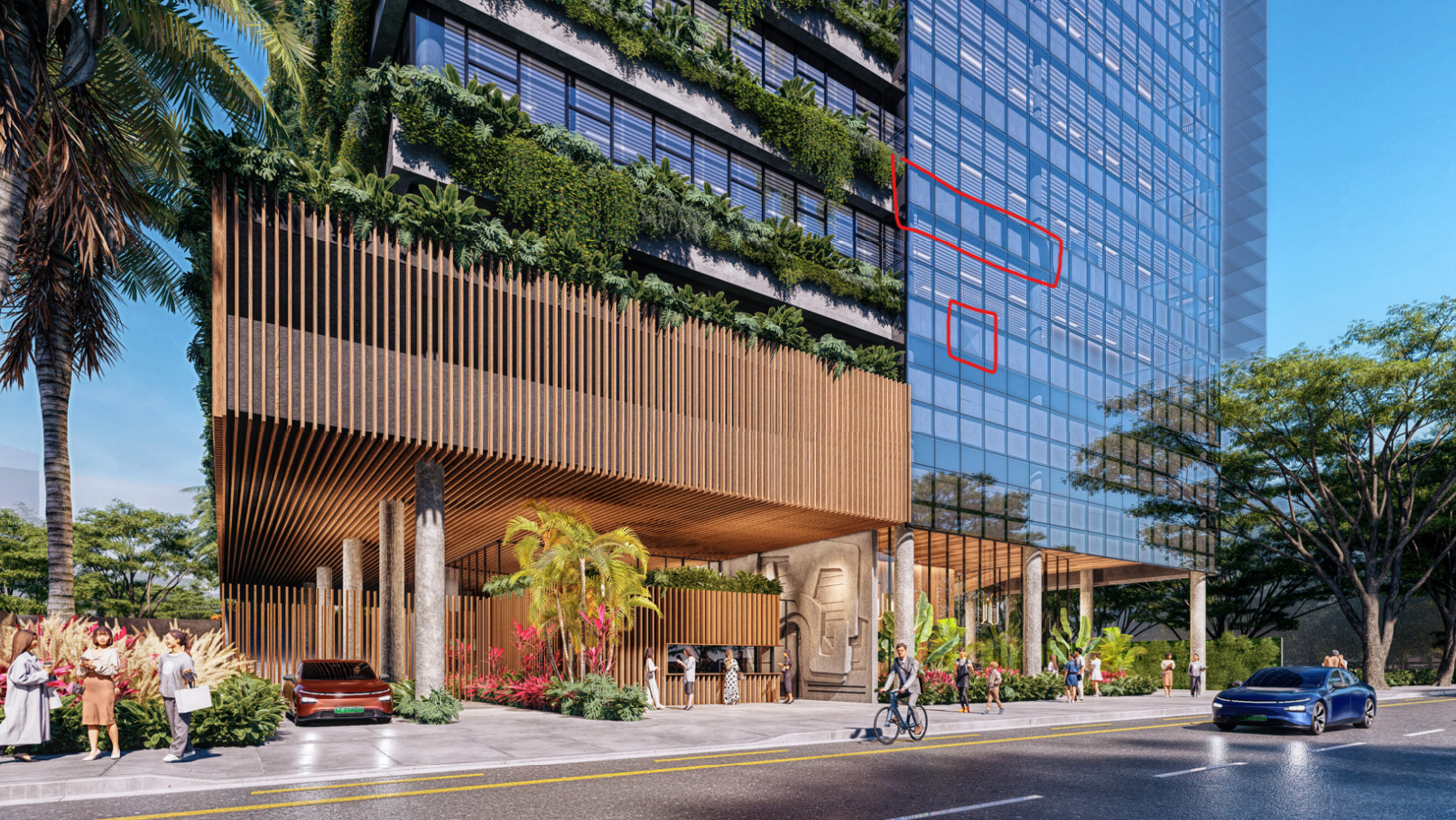

I just tested your file and the unwanted shadows are also visible on my end whenever I click on the “Clips” that you have mentioned. These shadows are not visible in my preview window and “Scenes”, is it also the same on your end? Nevertheless, I have reported this issue further to my team and will be working on how we can fix this immediately. Thank you.

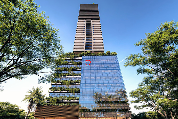

This shadows appears when the sun is facing directly the glass, like on those clips . it happens on static scenes and video as well. Ive tried to change materials, remodeled it with and without thickness, modeled with subdivided mesh but none of those methods solved the problem untill now.

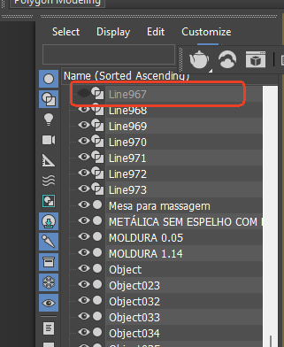

I apologize for the delay, since most of our team had a national holiday. Basing on our test, it seems to be caused by the interlayers behind this glass. The reflection is on the flat surface behind the glass. And there are also spaces between the interlayers that would create shadows. When the sunlight comes through, the glass is transparent and you can see the shadows behind it.
Hiding interlayers(Object064 and Line967), the shadows won’t appear since they don’t have bearing surfaces.

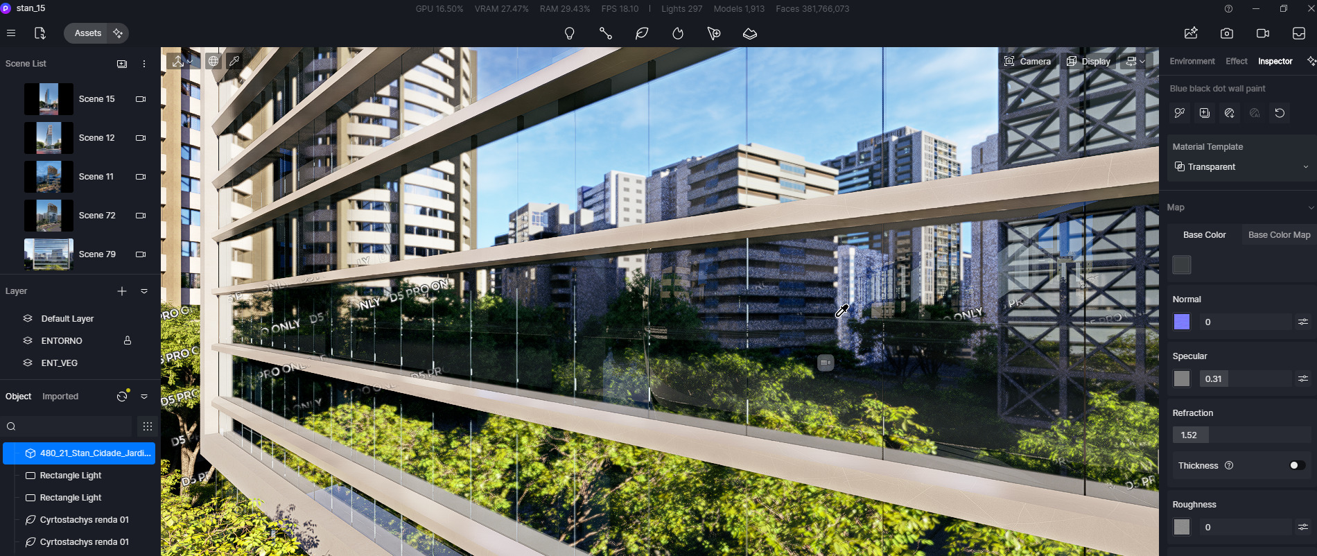

Hi @NOG_the_DOG
We were able to test the first file you sent to us since the unnecessary shadows were very prominent in that specific file compared to the latest file that you have forwarded.
It seems that the Custom Material causes this behind the glass, and changing it to Transparent from Custom Material eliminates the issue. I will be sending you a video recording of it via Direct Message, Please check your inbox.
