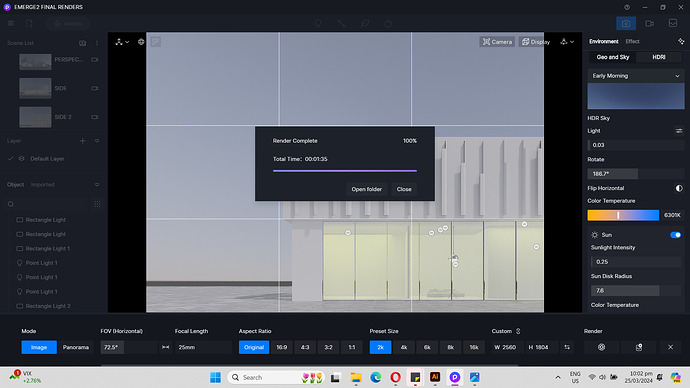

Hi I don’t know why I’m getting these weird black blotches if you look closely. I mean I can edit them easily with photoshop but it’s just inconvenient, especially how in the d5 software it looks completely clean.

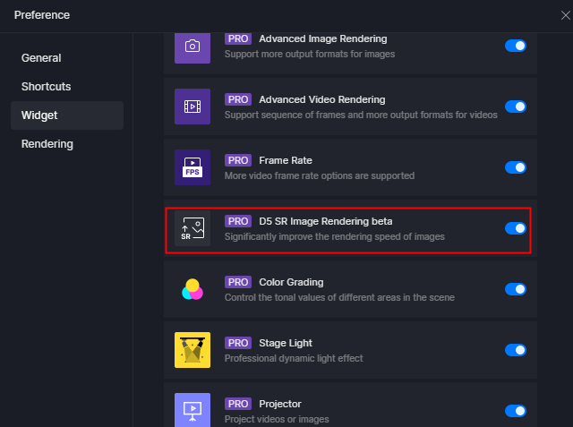

Sorry for your issue. What’s your D5 version? Did it occur in all scene-files or just this specific scene-file? It only appears in the rendered image right? Is your model far from the origin? Do you have SR on? If it’s on, we suggest you turn it off.
