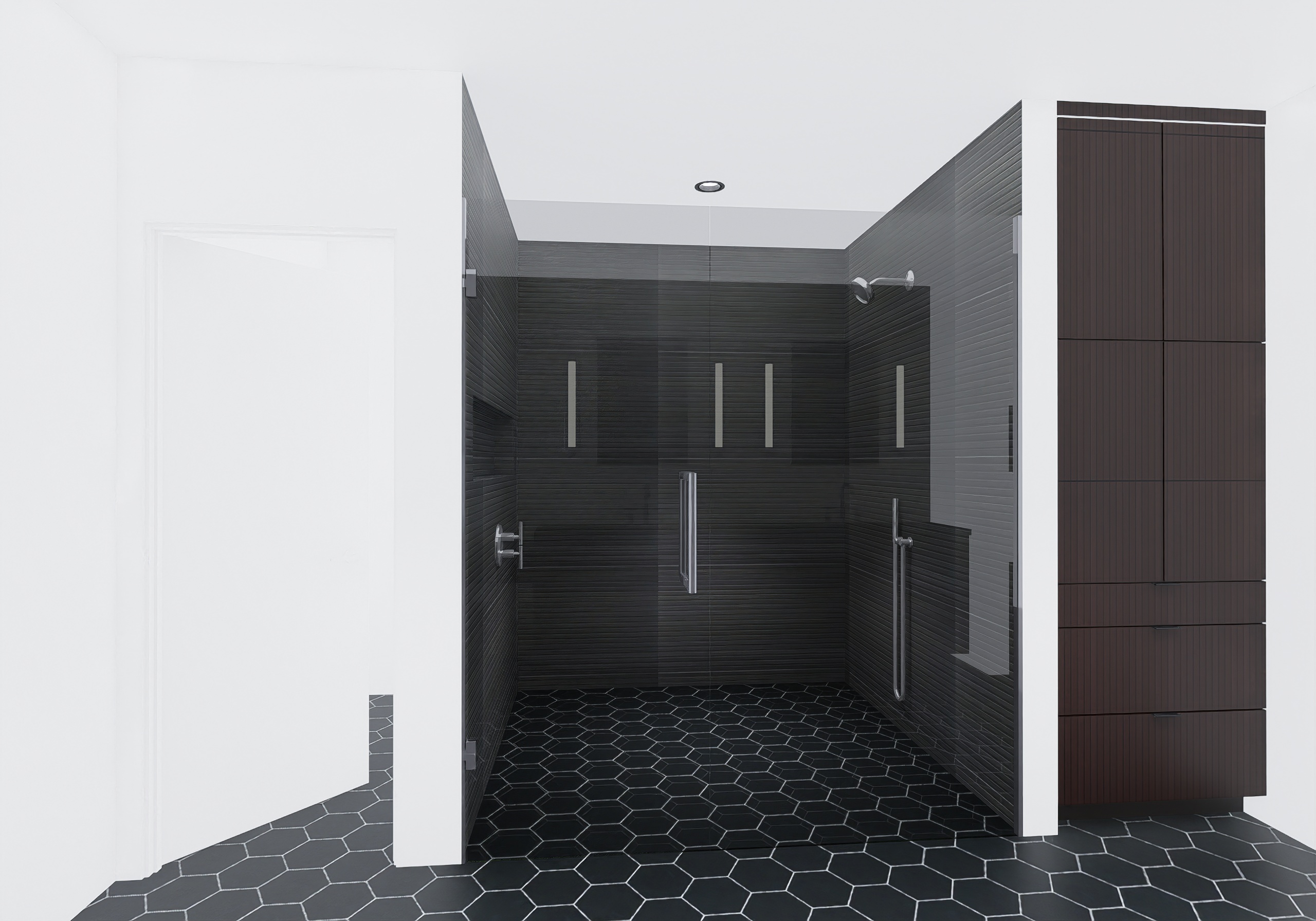

All,
Some of my interior renders seem to be washed out and I can’t seem to adjust any parameters to get more definition in the details (specifically the door jamb). I’ve tried turning all lights off, adjusting brightness, but nothing seems to help. Thoughts?
Steve
Hi @steve3
  • Have you tried modifying the surface’s colour? Use the material picker (Press “I”) tool, then select the wall, and then you’ll have access to the material parameter.
  • Disable Auto Exposure
