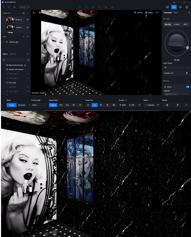

Hi, I am trying to fix this wall, but I really don’t understand why the texture is different when I export the image. I changed the roughness and specular, now they are both 1, I removed most of the lights, but nothing … why am I seeing all this white dots that are not in my model?

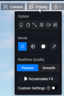

what display mode do you use?
Hi julienfischel,
yes I am using a material from the library.

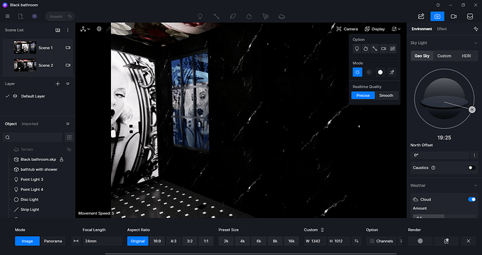

This is my display mode

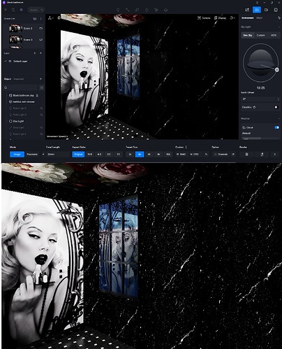

Hi @Ellys2981
I was able to replicate the issue on my end. I have reported this further to our team.
Thank you very much!!!
Hi @Ellys2981
Just an update regarding this issue from further inspection and testing. This is currently under expectation since the final render has a more precise calculation of light + materials. We suggest pressing F9 to match the sampling quality of the final render temporarily.
