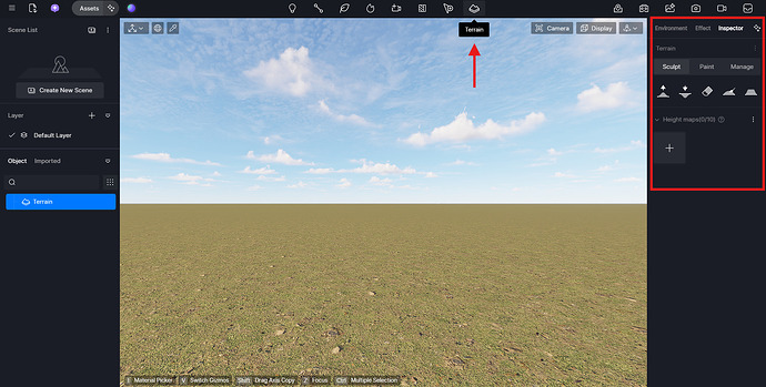

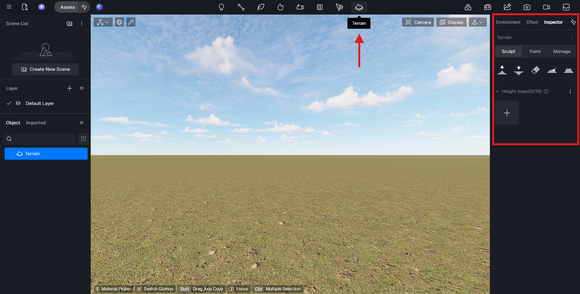

Hi @julienpaulus
Could you provide a screenshot or short screen recording showing how the camera behaves in Walk Mode on your infinite floor from Rhino?
D5 has its built-in Terrain feature which creates a default infinite plane (ground) that the Walk/terrain/landscape system recognizes properly. Please check it out and see if Walk mode works fine. Thanks :blush:
