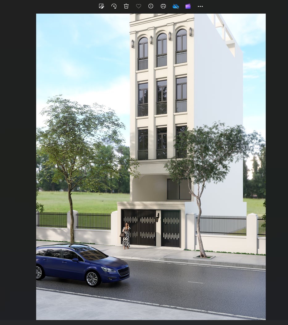

I have a problem. I have the exact frame set in the viewport and it renders it cropped. What’s the problem. This appears too in two model.
Can you record a video to show the problem or send the scene to us for troubleshooting? Thanks a lot.

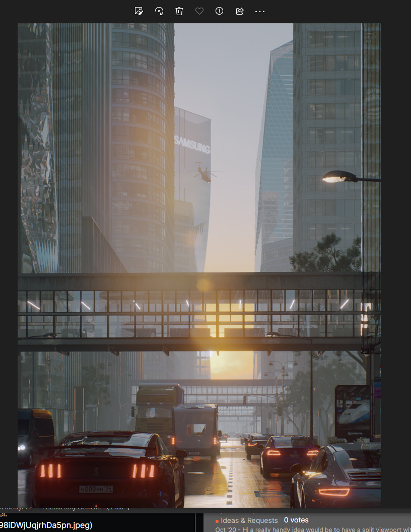

I am also experiencing the same issue, the output is a zoomed-in crop version of the camera I set inside d5, for the animation sequence I am working on right now.

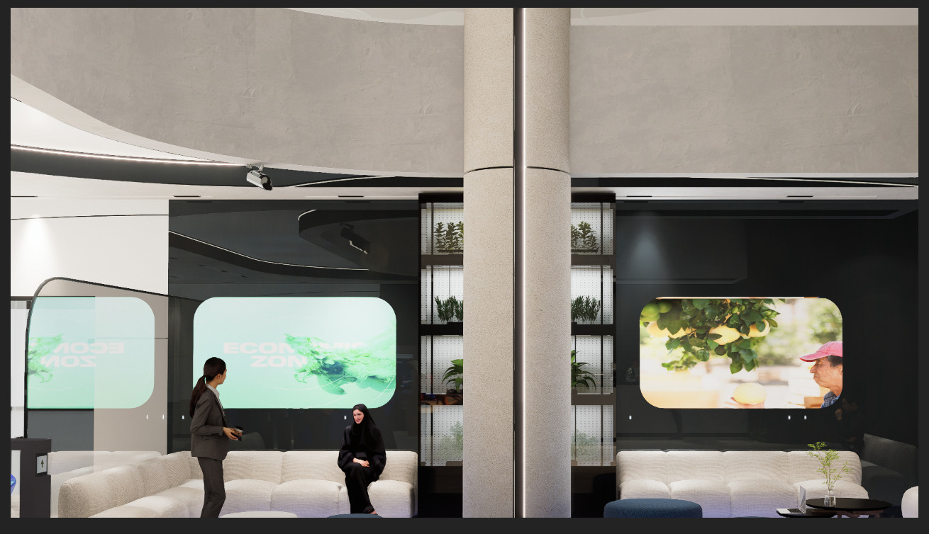

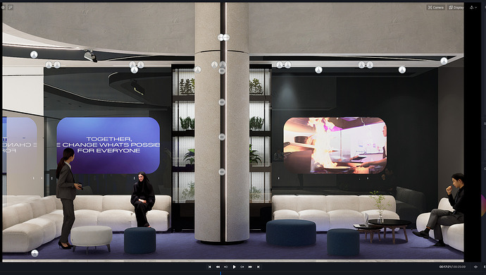

Image 1: Screenshot from D5 camera video mode
Image 2: Screenshot from AE of the output
Also noticed it resets back to perspective mode from a two-point perspective automatically.
New file, version 2.5.1
Sorry for the inconvenience caused by the problem, We have repaired this issue in 2.5.2 which will be released soon.
Thankyou for the confirmation. In the meantime is there any workaround for this issue?
It will be released after 1 hour, if the problem still persists, please tell us your detailed setting s of the output. Or send the scenes to us for troubleshooting. Sorry for the inconvenience.

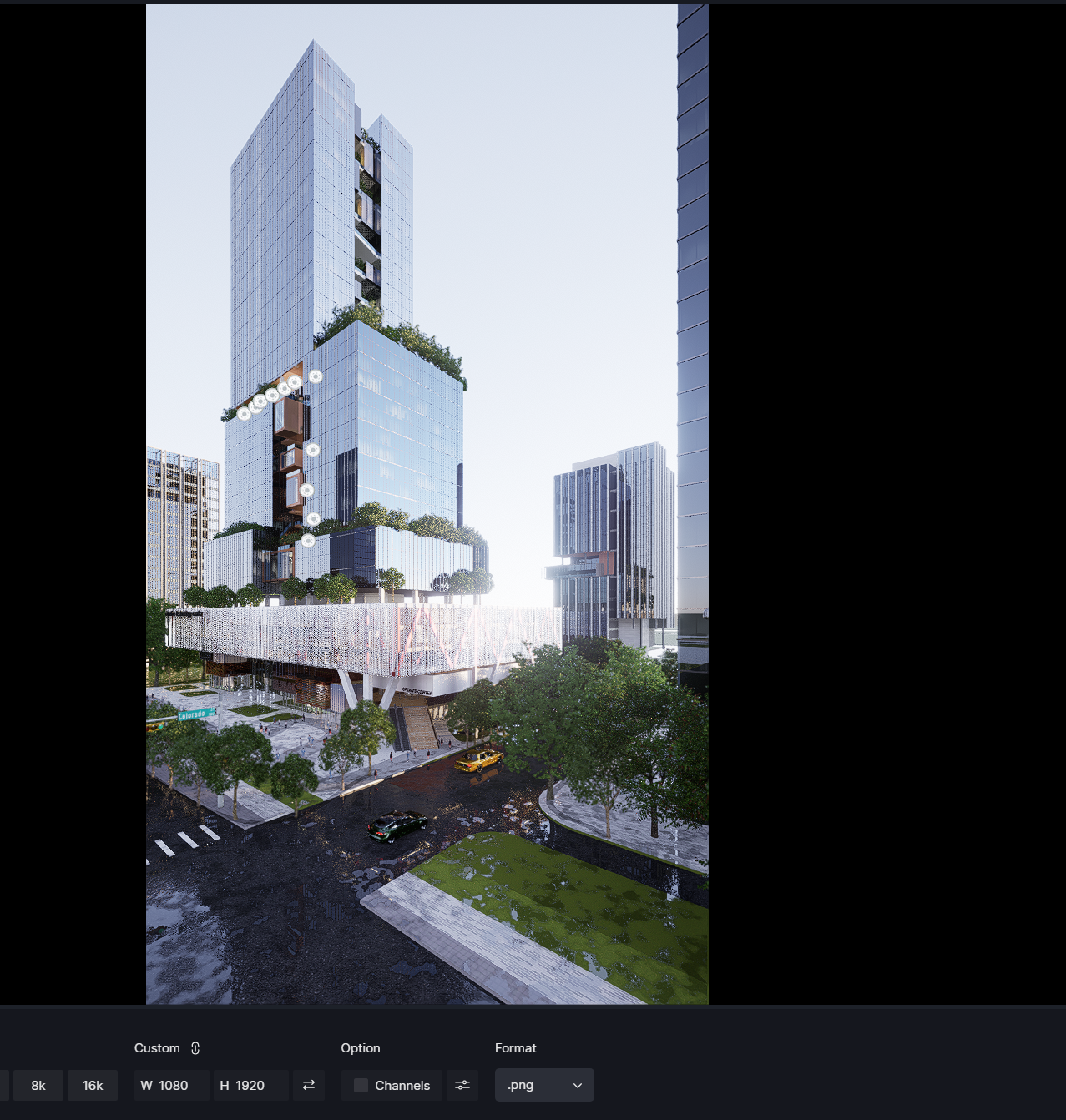

I have the same problem now, using the latest pro version

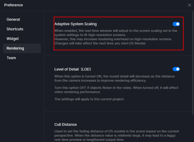

Sorry for your issue. Could you please tell me the size and ratios of your screen? Also, you can check if you have opened the “Adaptive System Scaling” and try to render again.
If this could not help for solving your issue, please send your D5 file to us (support@d5techs.com, please describe the problem and attach the link of this post to your email). We will check it as soon as possible.
In addition, you can try to update your driver to the latest version.
