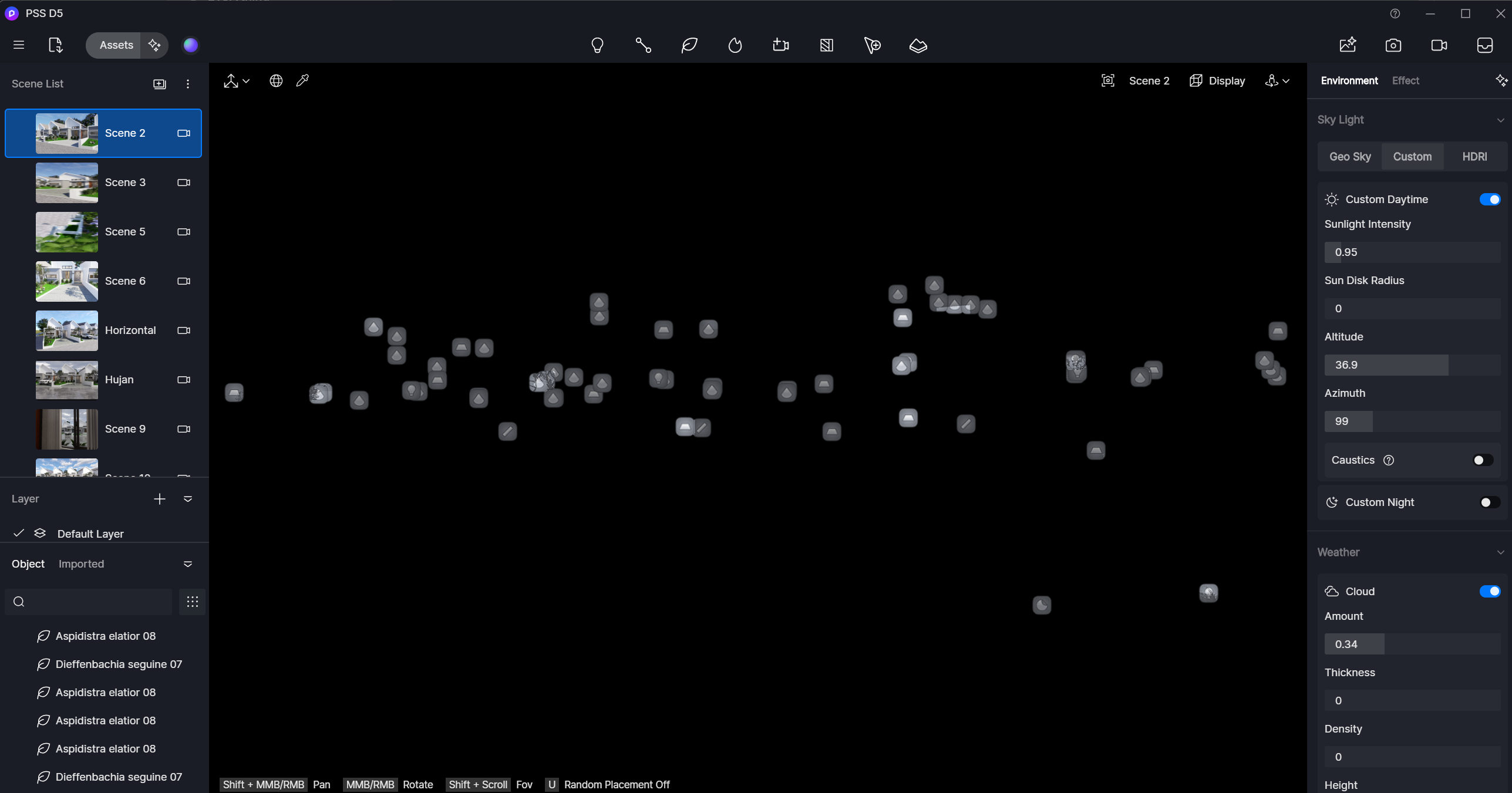

I am writing to report a technical issue I have encountered with the D5 Render application. For the past few days, I have been experiencing a consistent problem where the application displays a black screen and exhibits flickering behavior.
**Description of the Issue:
- Black Screen: Upon launching the D5 Render application, the main interface fails to load and instead displays a completely black screen. This issue persists irrespective of the project I attempt to open.
- Flickering: Additionally, there is a frequent flickering effect on the screen, which further disrupts the user experience and makes it challenging to interact with the software.

The recording is just an example. I only used nvidia recorder. When I turn off the recording it stays flicker and blackscreen. I tried to open file you suggested and it no longer flicker.

but my project is black

I tried to reopen my project. Keep flicker and black screen. Is there an error in my project file? it’s happened after 2.10 update.
It’s fixed now after deleting a Scene from my project. My project almost reached 50 Scenes. After deleting it, my D5 returned to normal.

Thanks for the update. To clarify, you didn’t experience this issue in version 2.9, even with nearly 50 scenes, correct?
One possibility is that enabling Path Tracing in 2.10 increased VRAM consumption, leading to the black screen. If Path Tracing wasn’t enabled, could you please send us your complete D5 scene file for testing? This will help us pinpoint the cause of the issue.
