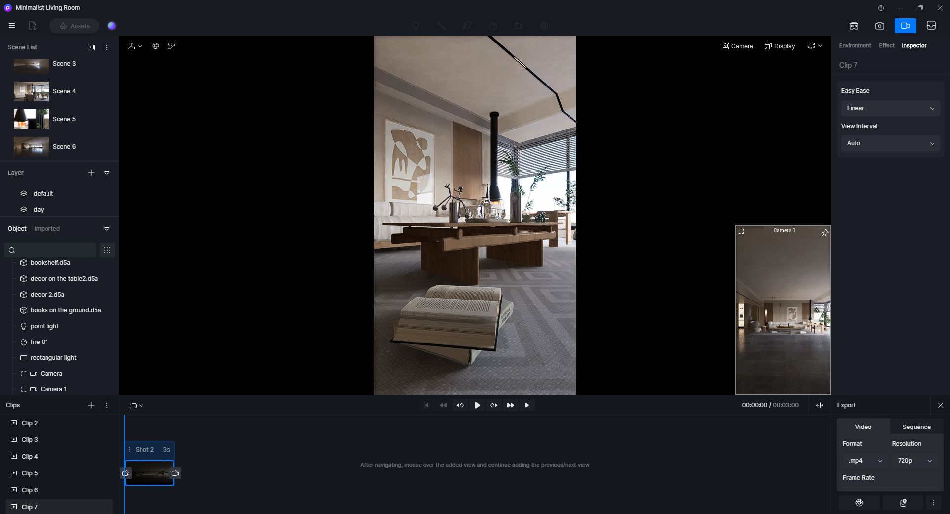

Does anyone know what the development status of the video aspect ratio is? (to this day) I continue working in Vray only because I can’t find this function in D5Render, and in 3dsmax vray if I can do it. It would be great to be able to switch to D5Render entirely but I personally consider this a very basic feature in any render engine.
Perfect, now I understand, I have to add the capture from a camera configured in the scene, I couldn’t find it because I was looking in the “video” section of the scene browser, well the important thing is that it can now be done, thanks for the answer.
