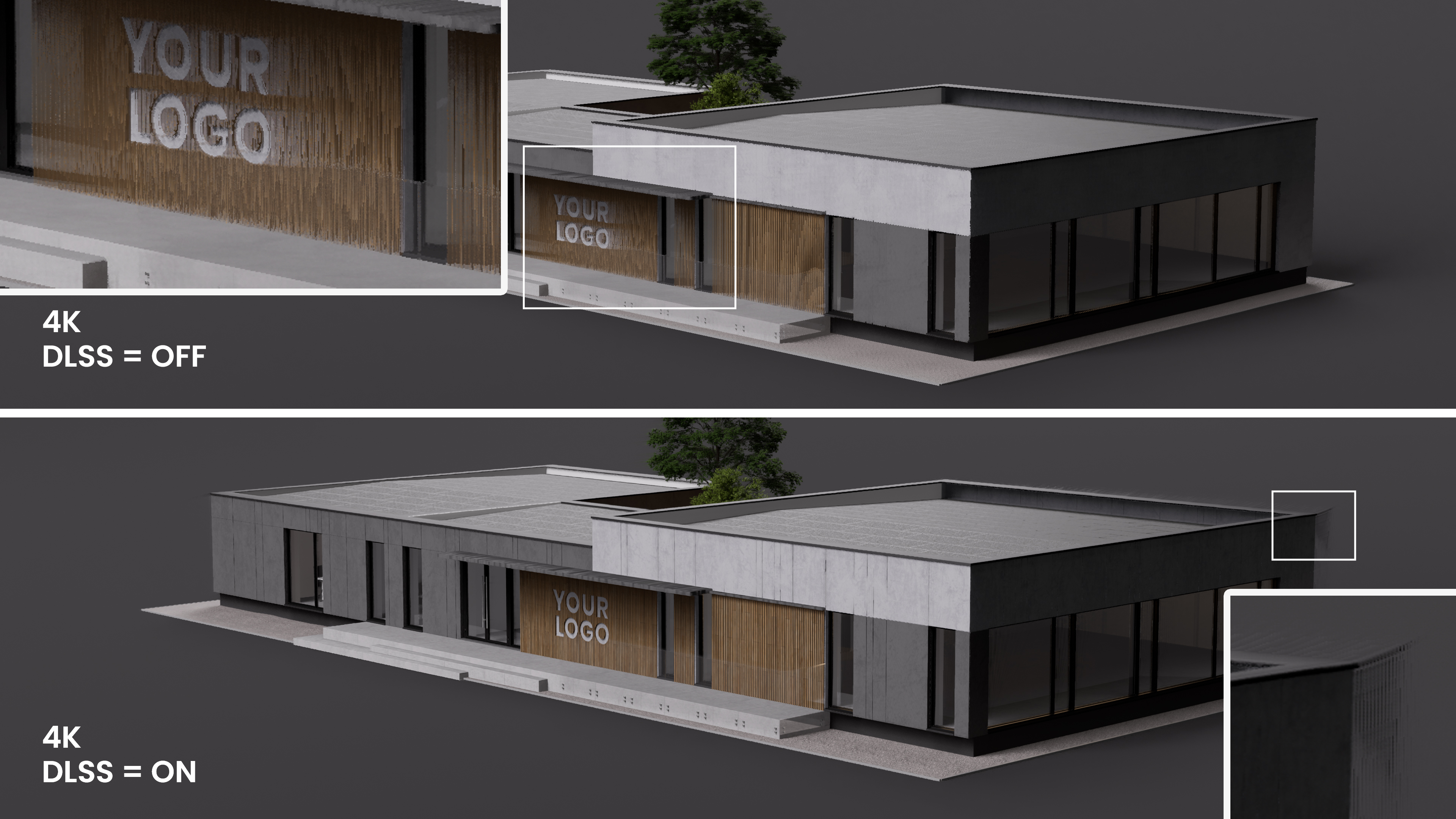

Is possible to avoid ghosting of fast moving objects or fast moving camera?

Normally turning off DLSS can solve this kind of problem, but from your screenshot, it seems there are other types of ghosting. In the video, the whole house has a movement animation?

Front panel with YOUR LOGO title is made from wooden 3x3cm panels.
Turning of DLSS cause ghosting on the front panels.
Turning on DLSS eliminate ghosting on the front panels but cause on the right top edge of building.
I think it;s because of lighting scenario. Thank for help.

I have the same drivers. And You have right - with slowly movement of camera or object, there is no problem with ghosting. Try to move camera or object faster. ![]()
