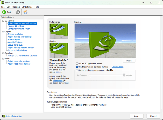

  • If you have an NVIDIA Graphics Card you may want to check its control panel and see if it’s running on high-performance mode
Any of this could and could not be a work around for this issue but hopefully this will somehow alleviate what you experienced, thank you so much for your understanding~
