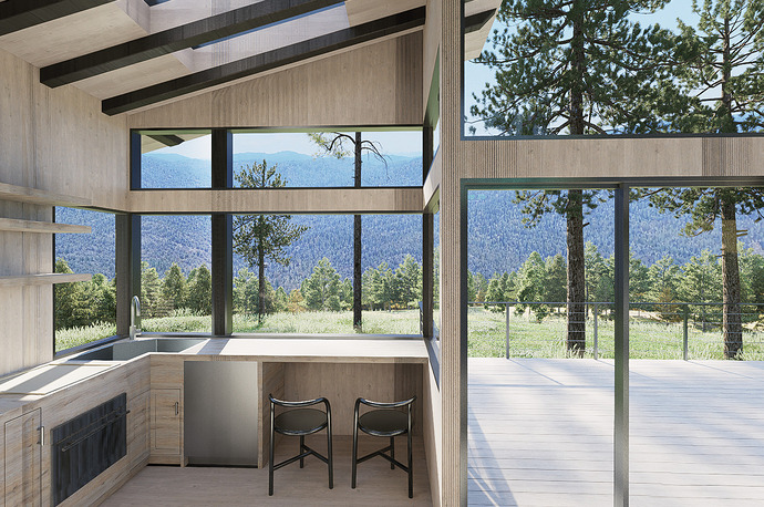

Please help!!! I am going mad… I am getting these horrible vertical artifacts and banding of some sort on the wood interior walls. I have tired everything… rendering at 4K, 8K, and 16K, dropping normal map of the texture to 0, changing the scale of the texture, changing from and HDRI to a geo sky, changed the lighting conditions. No matter what I am getting these artifacts on these interior views. Anybody have an answer?
maybe your model is too far away from the origin
I agree it is always something to check first…
What does that mean? It is where it was synced from Rhino? Are you talking the origin in Rhino or in D5? Thanks!
first check the distance to origin in rhino
It was totally that… I didn’t even know that was an issue. I have placed assets in my D5 file and all of my scenes are set up. Is there a way to move all of the assets with the model? Because now the scenes are bare and the assets are all over where the model was.
i’m afraid there is no easy solution for that and aou have to place them again
You can group your project and all your assets and move everything, right?
