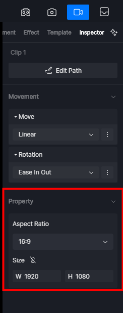

Different from 2.5 version, now if a camera is activated and you go to the video mode, the viewport will not be in the size of that camera set. Instead, the viewport will be still fixed to 16:9.
In 2.6 version, if you want to adjust the aspect ratios of video clips, you need to enter Video mode first, then select the clip and adjust the parameters individually. Thanks for understanding. ![]()
