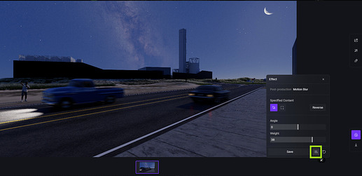

Hi there, where is the tail light check box feature shown in the promo for this release?
your original image with tail light check box…
screen grab of my open session (no check box option)…
what am I doing wrong?

May I know which D5 Render Version you are currently using? It seems to work on my end after setting the Weight and selecting the model. For reference, I am using a Vehicle Path and, at the same time, a single vehicle asset.

V2.10. I think maybe part of the problem is there is no tutorial on how to use this tool… unless there is, and could you please point me to it?
I am unclear how you managed to do two different selection sets for that matter. Mine has none of those features. I am glad it is working on your end, but could it be because you made a vehicle path? I am not clear on a ‘single vehicle asset comment’ since I can clearly see two vehicles in the scene. Also, is this feature only available for native D5 assets, or is it tied to emissive materials? The two cars in my scene are not D5 assets, but models I made into locals.
  • This feature is tied to the Vehicle Assets from our Library since these models has an option to enable the Lights. Inserting a point light or enabling emissive material will not trigger the option: “Tail Light” in AI Tool.
