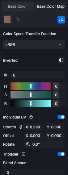

  • Even enabling individual UV in the base colour map does not really allow editing these surfaces separately.
  • For now, I think having these surfaces assigned with different UVs or, as you have said, changing the UV Wrap in Rhino, are the only options.
