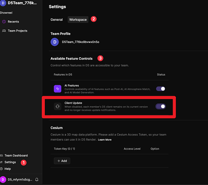

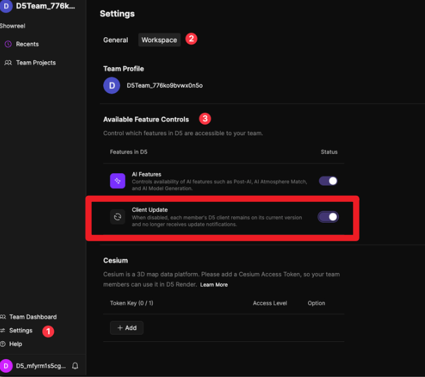

  • May I know which type of license you’re currently using?
  • Were you able to contact us before about the Educational License collaboration? If so, please provide us with the email address used.
Note: You may send it to me privately here in Forum.
Currently, this option is only available for D5 Teams. We may still need to confirm if this is possible with the current license that you’re using.
