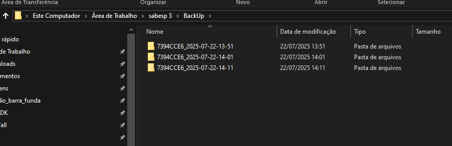

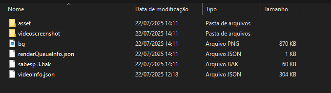

( there are files on backup folder buit i cant open then)

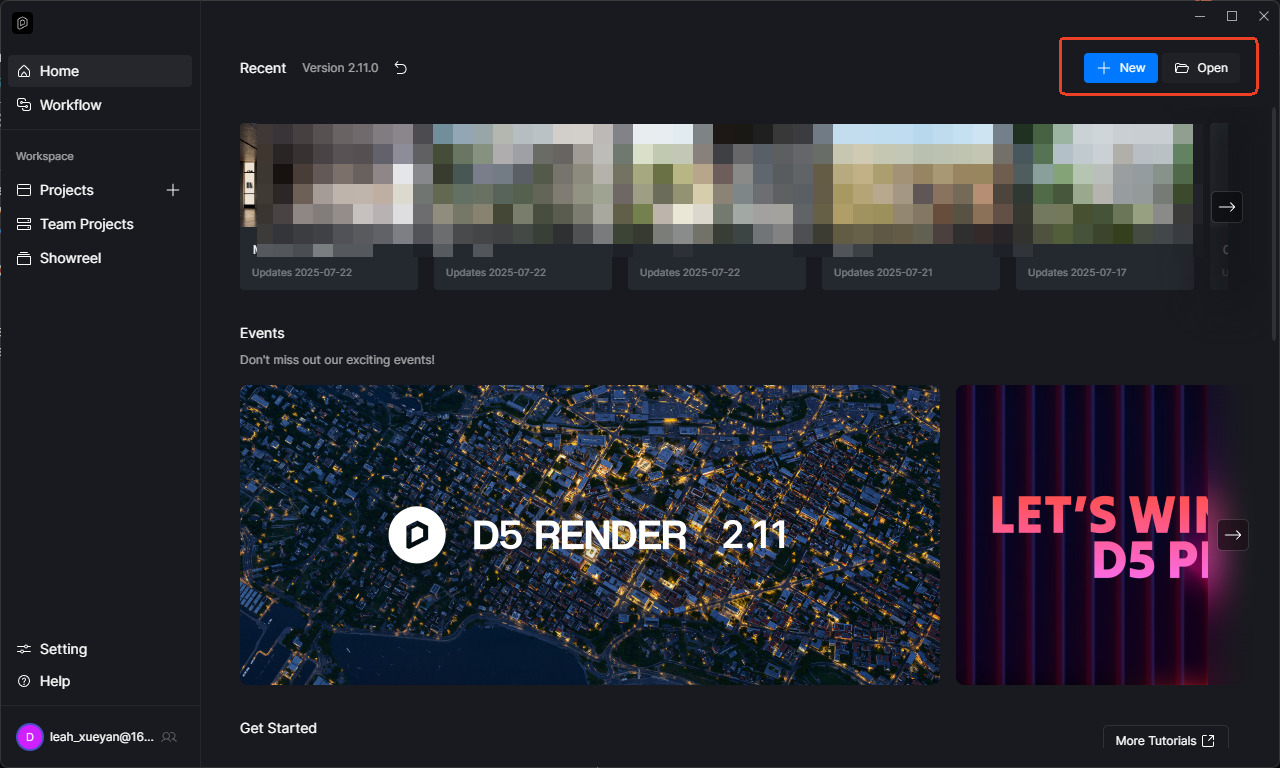

Hello @NOG_the_DOG
In version 2.11, the welcome page has been updated to D5 Launcher. If you click D5 Render program, it will enter an empty scene by default. It’s recommended to start D5 Launcher and access projects via it.
