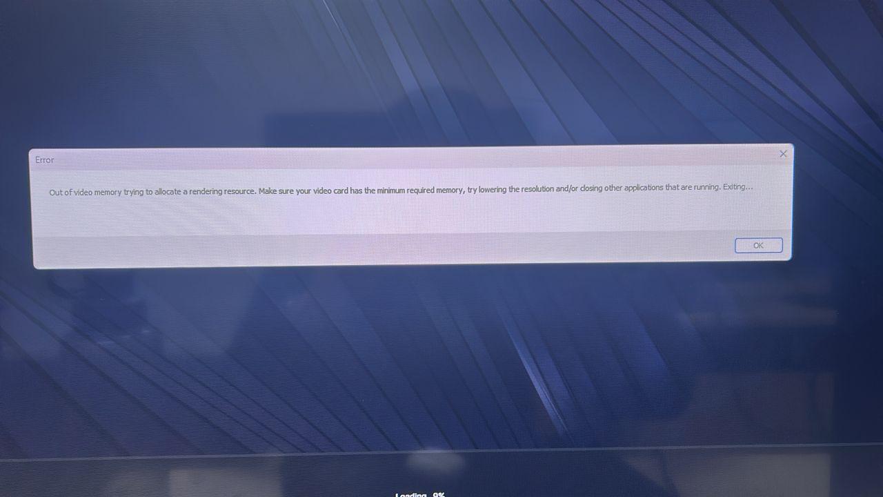

However, two days later, the file refuses to open. I’ve tried creating a duplicate copy, but it still won’t load. It shows an “out of memory” error and stops loading at specific percentages each time.

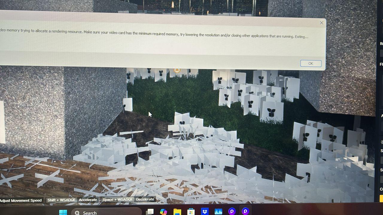

I attempted to delete the largest scatter file from the backend, and while the model briefly opened, D5 crashed shortly after.
I have an upcoming competition, and the file is already finalized, so reducing details isn’t ideal, but at the moment, I can’t even open the file to make adjustments.

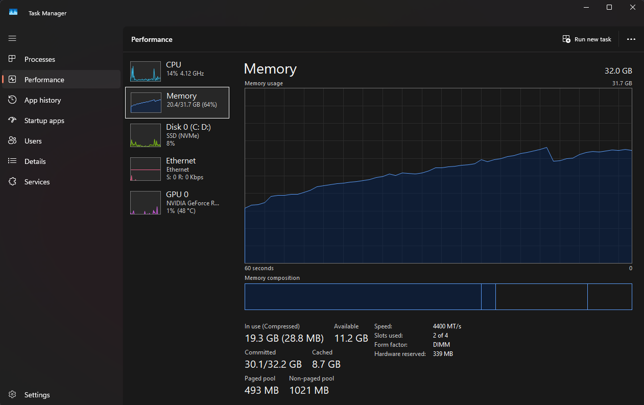

I can’t seem to find a PC with higher specs and attached D5 license (I have a lot of pro assets) to check if its issue with my file or open to try and optimize it. I can see when while opening up the D5 file that ram usage (task manager) goes all the way to 21GB/32GB used when the file crashed.
Could you please advise how to resolve this issue or recover the file? its 3 months of work. it has everything set up including scenes. I want to render videos from it now. I have tried using many fixes already in the forum and the error seems to be with memory. How can I optimize the file without deleting stuff from it with it refusing to open?
*I have tried to open the file on my friends PC with same specs, with their education license and the error is same.
*One of the images here are after I deleted a scatter file. It briefly opened only to shut down in 30 seconds after hanging up.

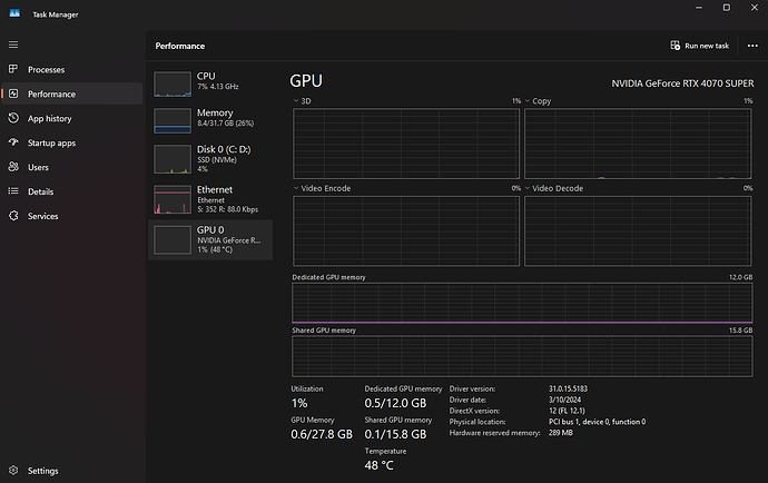

Hi @ahmedbaig311 Could you check the VRAM usage when attempting to open this file and share a screenshot of the Task Manager showing the GPU?

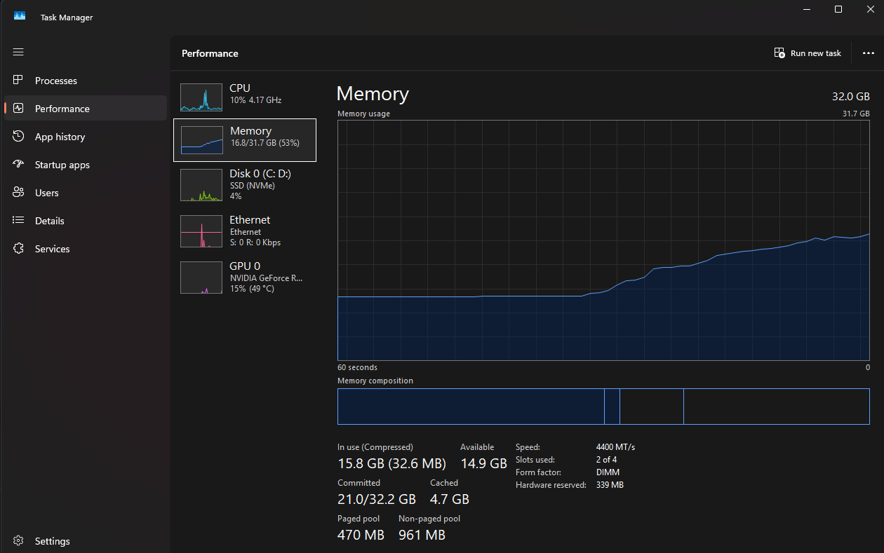

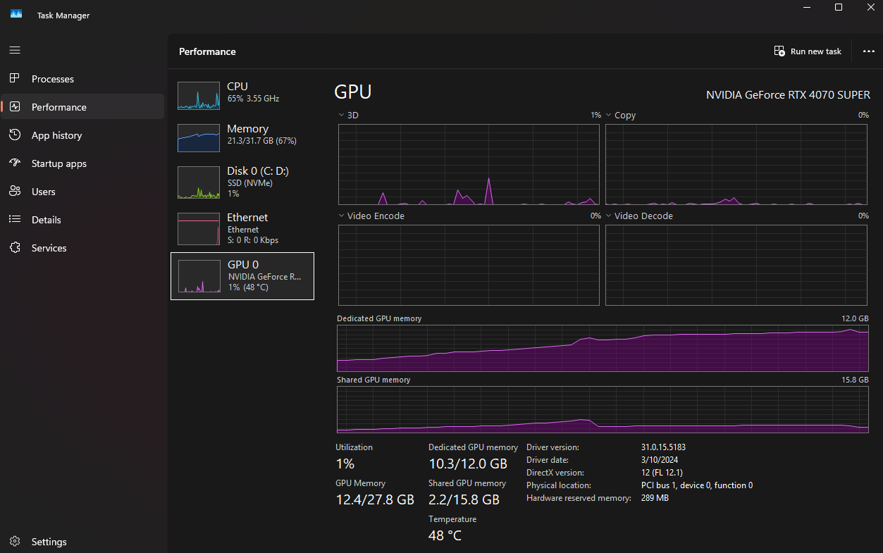

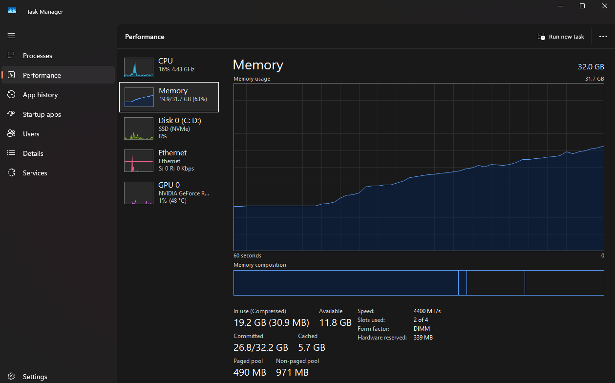

Hello D5 Team,
First of all, Thank you for assistance and removing procedurally gen content. it made the file lighter but kept the same vibe. Really appreciate.

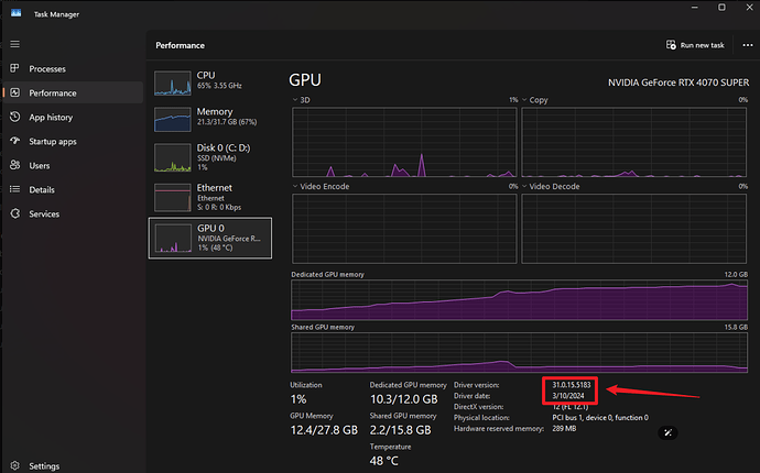

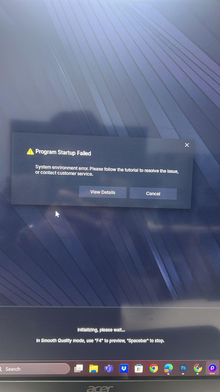

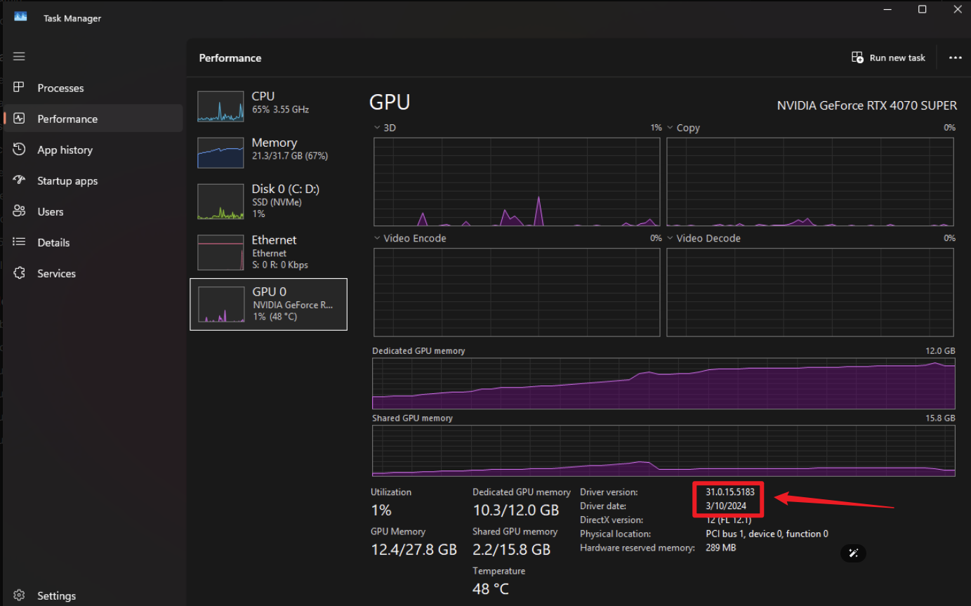

So I have tried to open the file. it opened only once. I moved around the model for 5 seconds and it crashed again and is not opening anymore. I am attaching the screenshots of task manager until the file crashes on loading screen. I suspect there is some texture that could be corrupt? Is there anything else that can be removed to make it lighter? It also could be something else as the file was working 100% fine even with all the details before. (however, I do admit procedurally gen content did start making it laggy) I rendered around 30 images on 2K/4K last time I used the software. saved it properly. Made a backup and closed the program.
Thank you!
Hi @ahmedbaig311
In addition to removing some assets from your D5 file, I strongly recommend updating your drivers. Based on the screenshot you provided, your current drivers haven’t been updated since October 2024. The latest available version is 581, so updating to that should help improve performance and compatibility.
