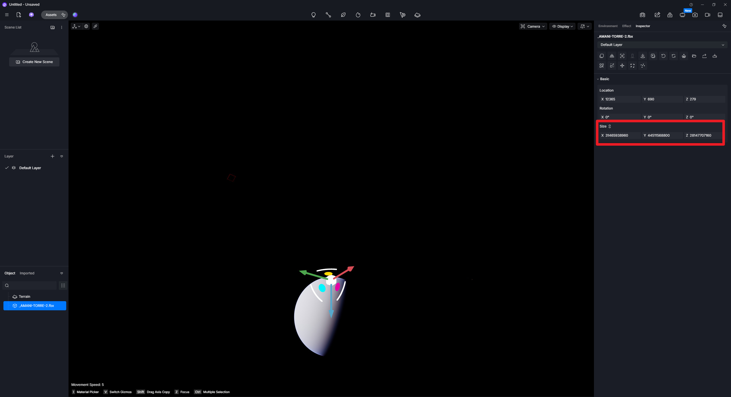

3.1.1.0755
I just tried importing the fbx file that you have provided, and the size is too abnormally large. Proceeding to place it in the preview space then clicking “Focus On” will result to this view.

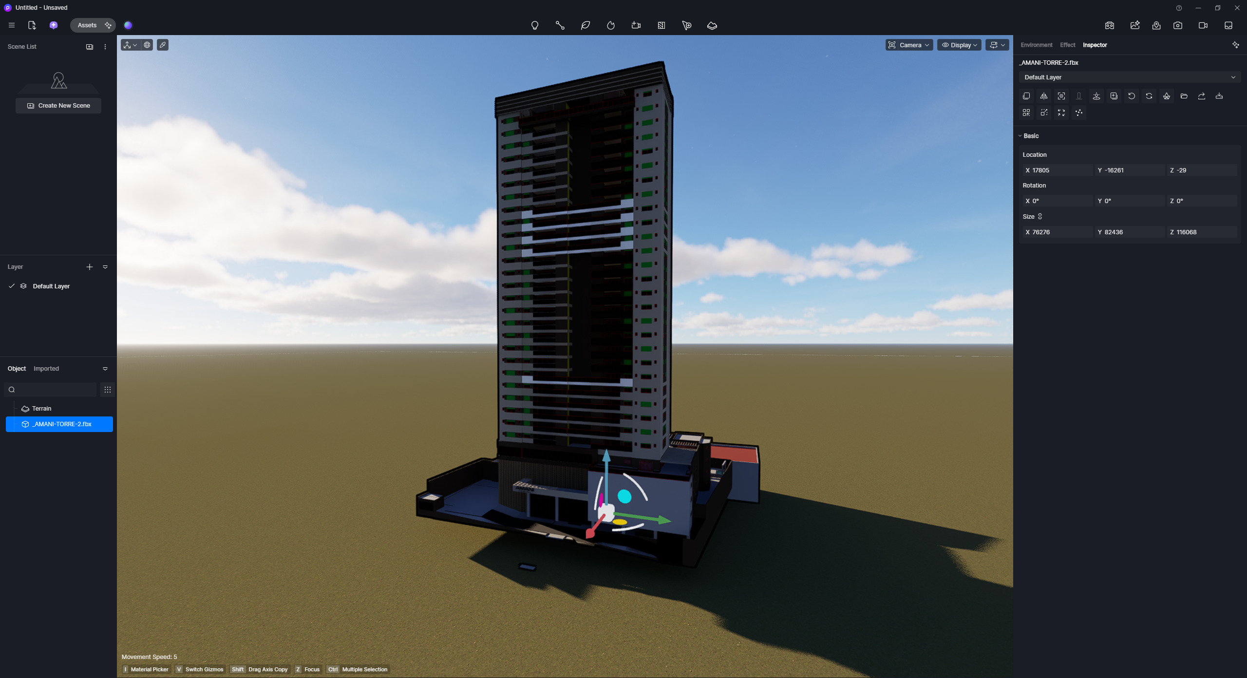

3.0.1.0746
I’ve also tested this fbx file in 3.0.1 and it does appear normal.
