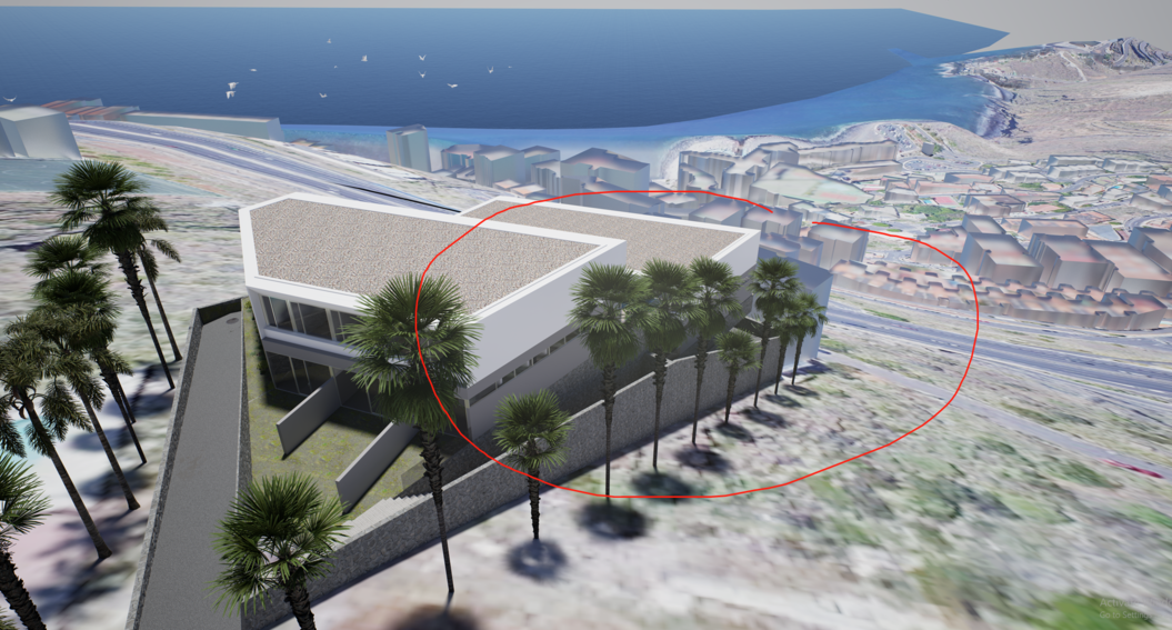

Hello, there seems to be a haze in certain parts of the rendering that i can not get rid of. All environmental options are switched off fog/clouds etc. Does anybody else have this problem?
Hi, this is known to happen when there are assets or models in the scene that are very far from the origin of the coordinates.
Please try to select the model in the Object List and change the Location to (0,0,0) to see if the problem still exists.
If it still exists, please send us this D5 scene file as a package to locate the cause at support@d5techs.com.
Thank you, i think that solved it.
