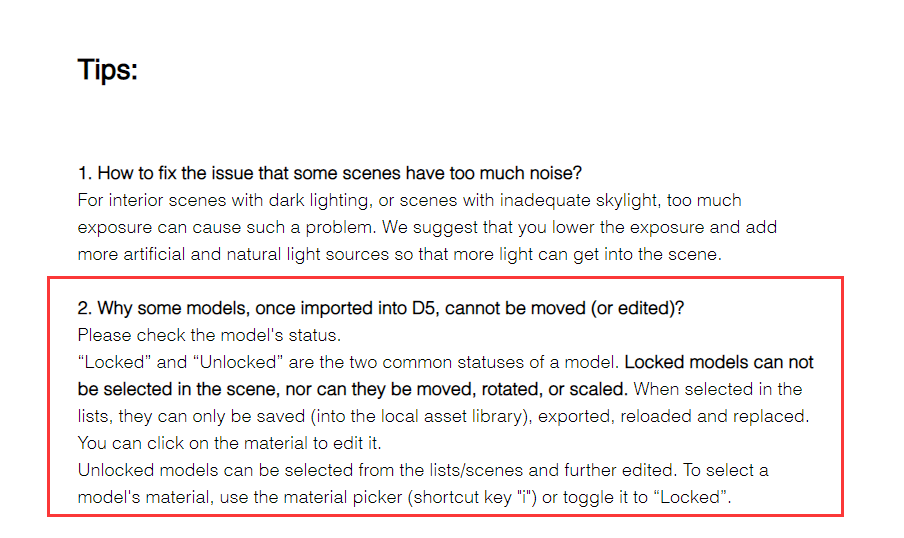

Hello, first, to select a model’s materials by clicking, we need to make sure the model is locked
D5 Times Vol.02 (d5render.com)
Please try using shortcut: i to select the material, or you could check the lock/unlock status of that model.
If the problem remains, feel free to let us know ![]()
Terrific. I didn’t realize that I could pick a material without highlighting it.
Thank you.
