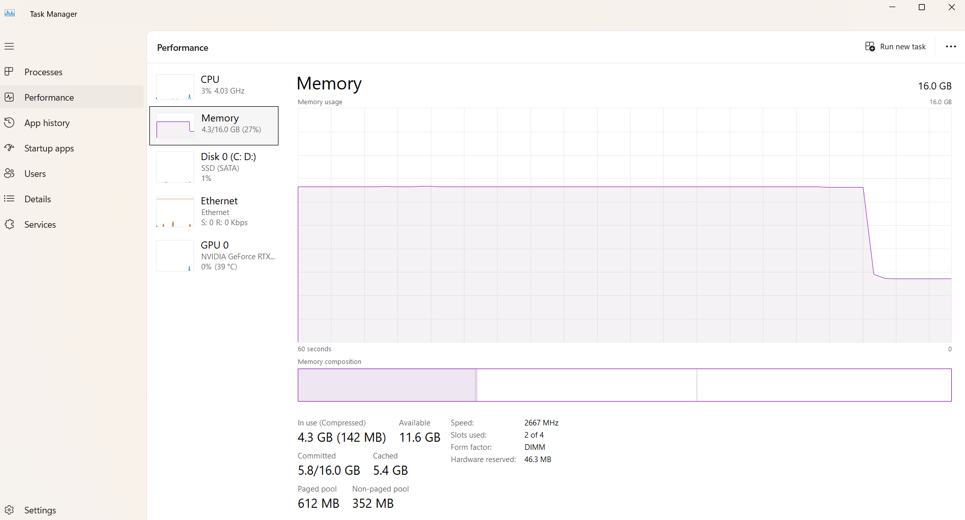

Following are the images of my system as requested.
System Info
VRAM
Memory
Thanks.
Hi @michaela
An out-of-memory error prompt usually means there are a lot of assets in your D5 Render file that may be too much for your device to handle, considering that you only have an 8.0 GB of VRAM. If the file size is relatively small, then it should work, but as the file gets bigger or complicated, issues may arise.
Hi @Clov
I upgraded my RAM from 16gb to 64gb rather than upgrading my VRAM from 8gb to 12gb. Works perfectly now.
