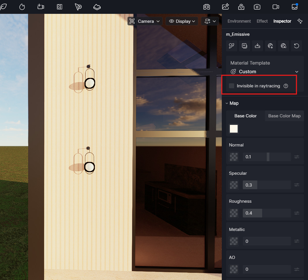

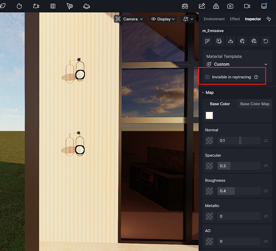

Hi @a.drexler
Just to clarify, what exactly are you trying to achieve? Do you want to remove all shadows in the scene or prevent specific objects from casting shadows? If possible, please provide a screenshot for reference.
At the moment, D5 Render does not have a full global “disable all shadows” feature.
To remove shadows from specific objects only, you can select the object and enable Invisible in Raytracing.
Good morning, Ela,
Yes, I’d like to remove all shadows from the scene.
It would be helpful if the shadows cast by a light source—such as the sun—could be turned off.
I’m aware of your suggestion to turn off shadows for individual objects.
It’s a bit tedious, but there’s no way around it with the current version of D5.
Bye
Andreas
Hi @a.drexler
Unfortunately, there is no global option in D5 Render to completely disable all sun shadows for the entire scene. The only available options right now are to disable shadows per object or reduce their effect using lighting/environment settings.
