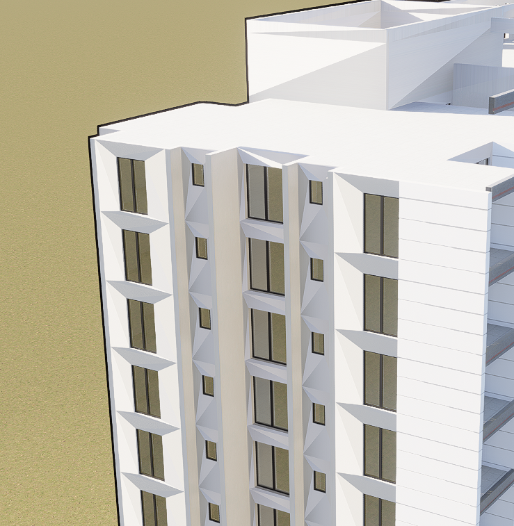

Having this type of reflection cuts while syncing from 3ds max. any help on how to get rid of it?
I have tried fixing normal in 3dsmax.
Thank you
Thank you
Can you send me the 3dsMax File? We may need to test it on our end. Please send it to support@d5techs.com and have it titled ‘Clov-Forum Triangular Reflection Cut Issue’

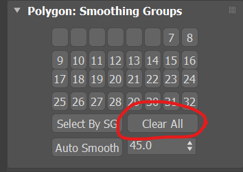

Hey, have you tried removing smoothing before the export ?
