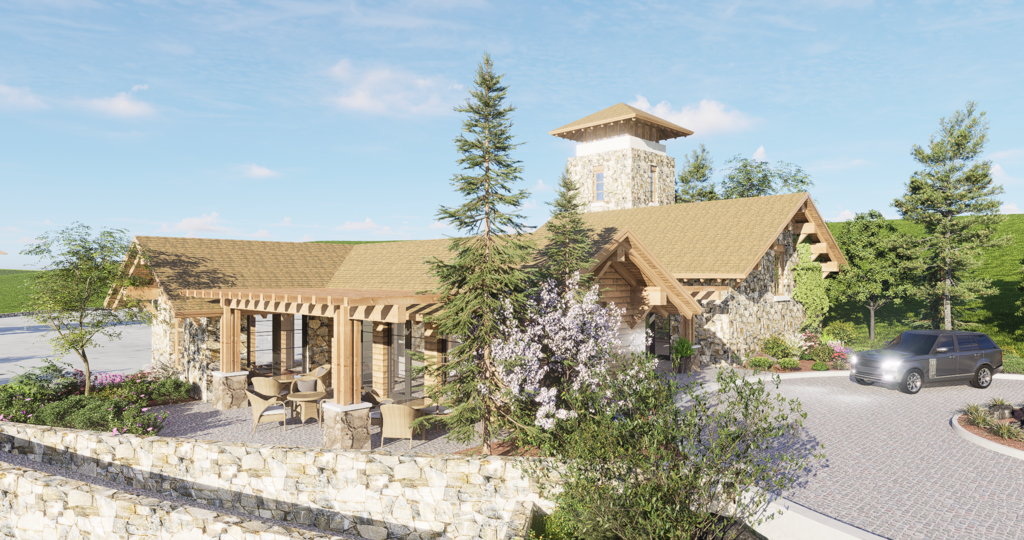

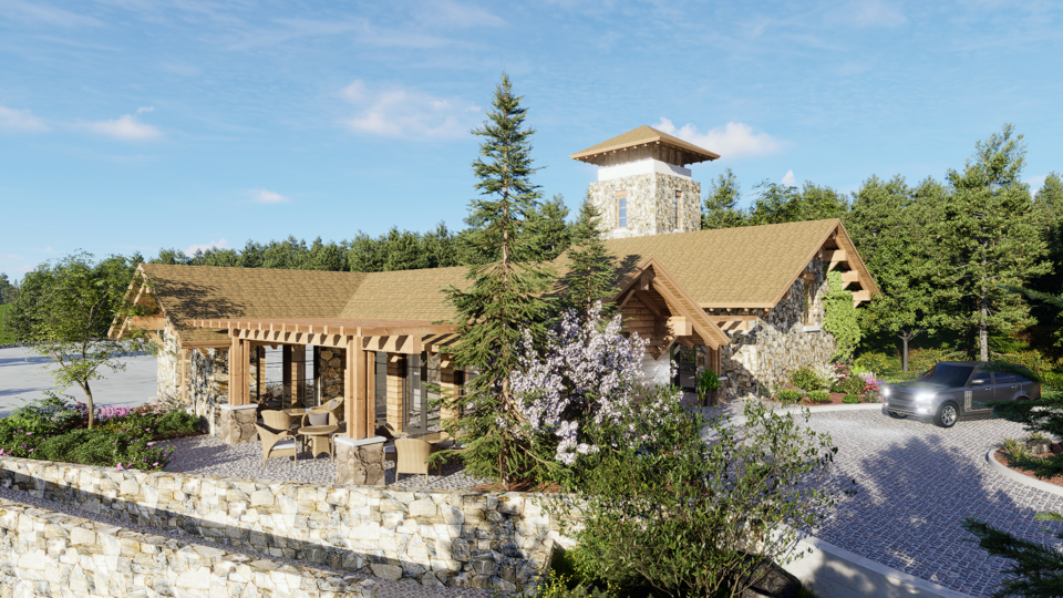

Hi here are 2 images… yesterday I rendered this test of a scene with D5 trees placed using the painting tool. today when reopening all the painted trees are gone. please help

sometimes i see same problem. when you close project and open again, some brushes are not visible. you should choose your model on the left panel. Then you will see brush records on right panel. i think name is brush history 1. select this and make invisible. then make visible again. you will see your brush
