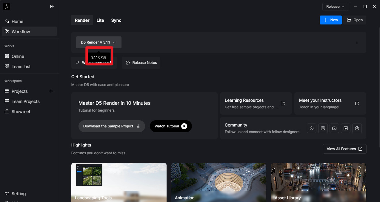

  • Which version of D5 Render are you using? Please check this portion

  • If none of these resolve it, please share your D5 version number and whether the trees are completely gone from the resource list or just not visible in the viewport.
