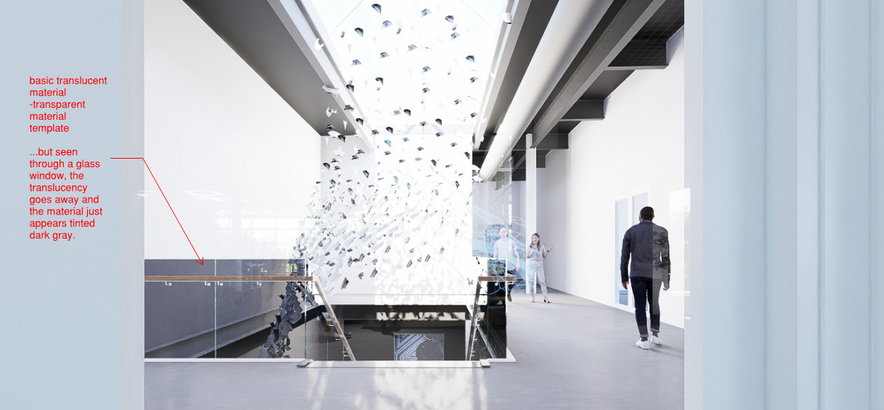

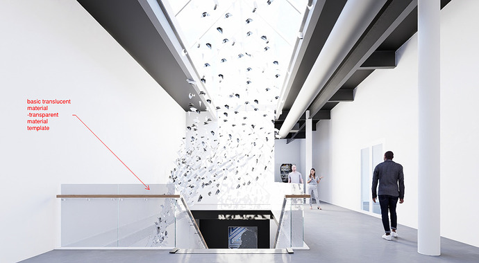

I am getting an odd effect when using translucent materials. When viewed through another transparent material, the effect completely changes. See the images provided.
-seen directly, the basic translucent material is perfectly fine.
-when seen through another piece of glass, in this case looking at the translucent glass guardrail through a clear glass door, the translucent material turns into a dark tinted color.
is this a bug?
Hi @mcdermoa
There was a known issue before that involved textured glass materials when viewed through a glass, it displayed a darker shade, but was resolved when PT is enabled.

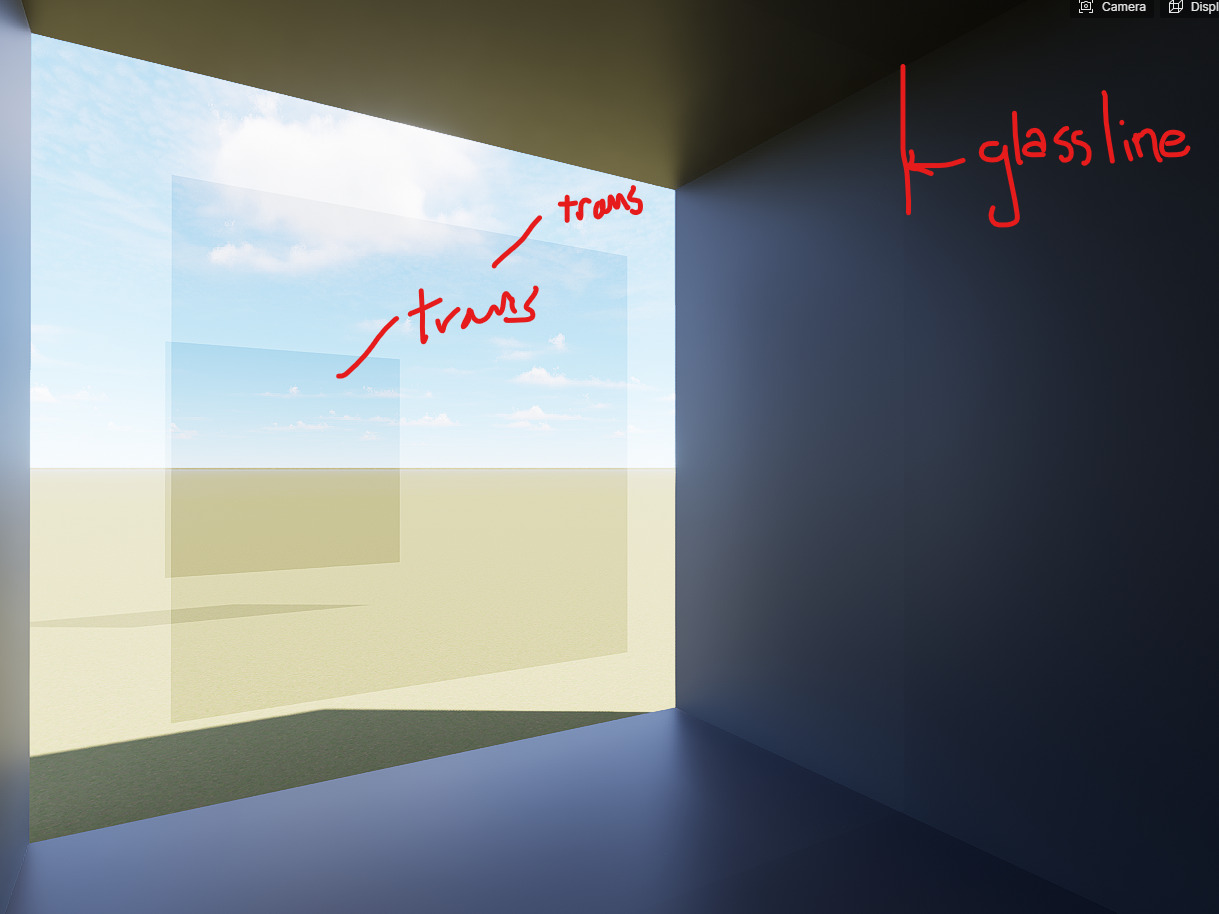

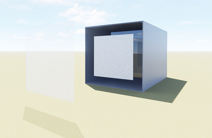

@clov,
I recreated a simple file demonstrating this and have emailed it to the address. Unfortunately, it happens no matter what. Also, noticing that translucent materials exhibit a “sided” quality, in that they look translucent from one side, and nearly transparent from the other, more like how a “foilage” material would behave, not glass.
Hi @mcdermoa
  • This issue is already considered a known issue (a bug), which will be further improved in subsequent releases.
  • As for the rear portion of the transparent material, which tends to have a milky texture, the issue has been replicated even on our end and will be further optimized.

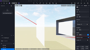

Hi @mcdermoa
I apologize for the late response.
For now, this is currently underexpectation since the Basic Semi-Transparent Material turns white where the light is directed, affected by the light source.
