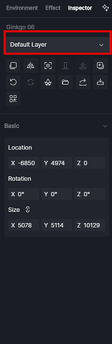

Are you wanting to categorise and manage assets in D5? If so, you can click on this button in the screenshot and then categorise the assets to view them. You can use this button to show only a certain type of asset and then change their layer via the menu bar on the right.

Hello, I may made some mistake before. If you use the plants asset as brush, they will just show in the brush record. This is normal. If you want to change their layer, please place them separately

It is possible to put plants on a layer if you place them individually instead of using them as brushes.D5 brushes currently need to be dependent on the face to exist. If you have some suggestions about brushes or layers, you can make them in the forum. Latest Ideas & Requests topics - D5 RENDER FORUM
