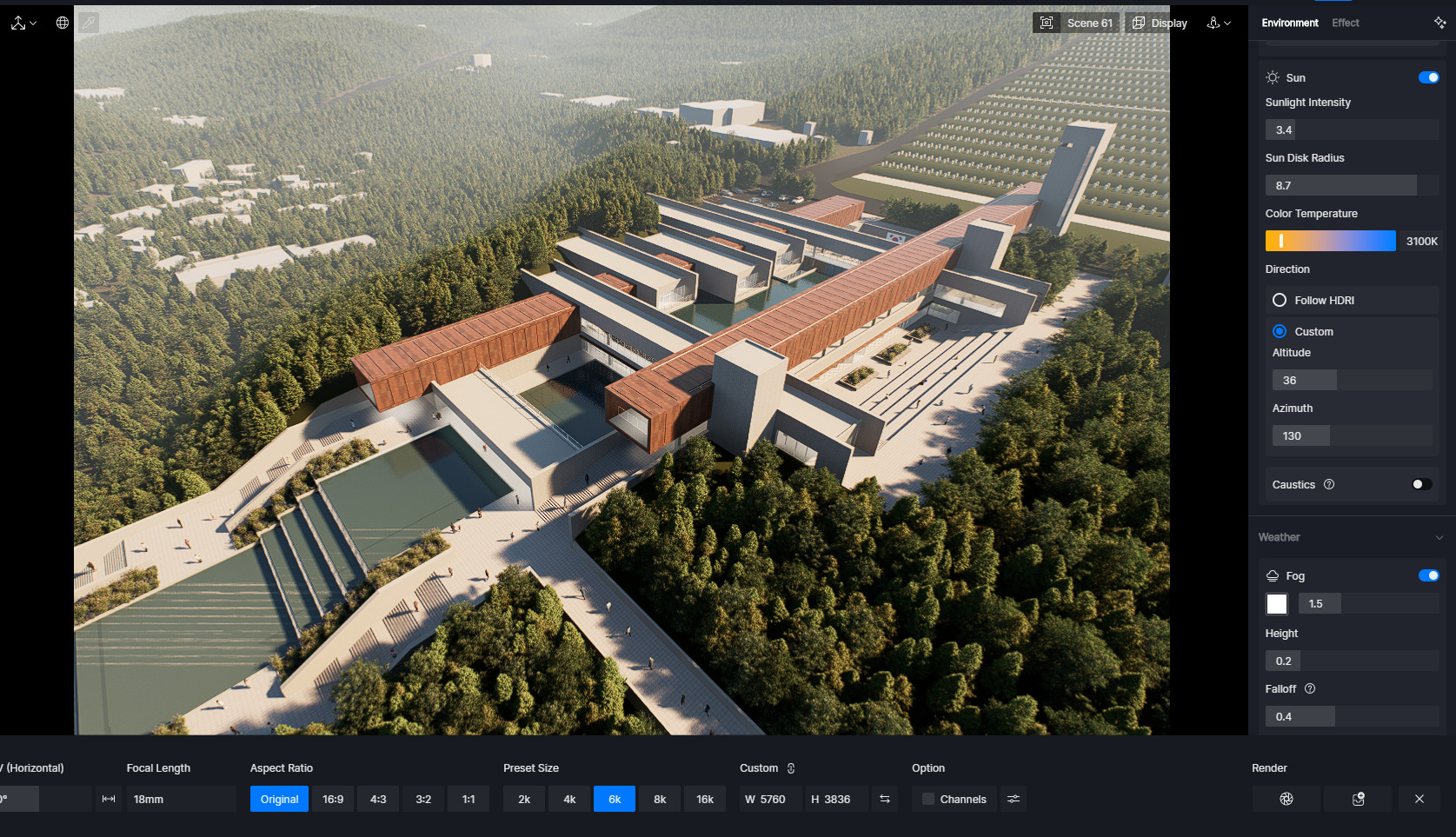

렌더링을 했을 때 물 쪽에 검은 선과 재질이 깨짐 - Get Help - D5 RENDER FORUM
Try to enable/disable the following:
- Super Resolution
- LOD
- Frame Generation
- FPS Booster
- You might want to check if your drivers are also updated.
If the issue persists, let me know so I can collect your log files + scene files. You may send your scene files and log files to support@d5techs.com and have them titled Clov-Forum 렌더링 할 때 물 재질에 흰색 사선이 생김
