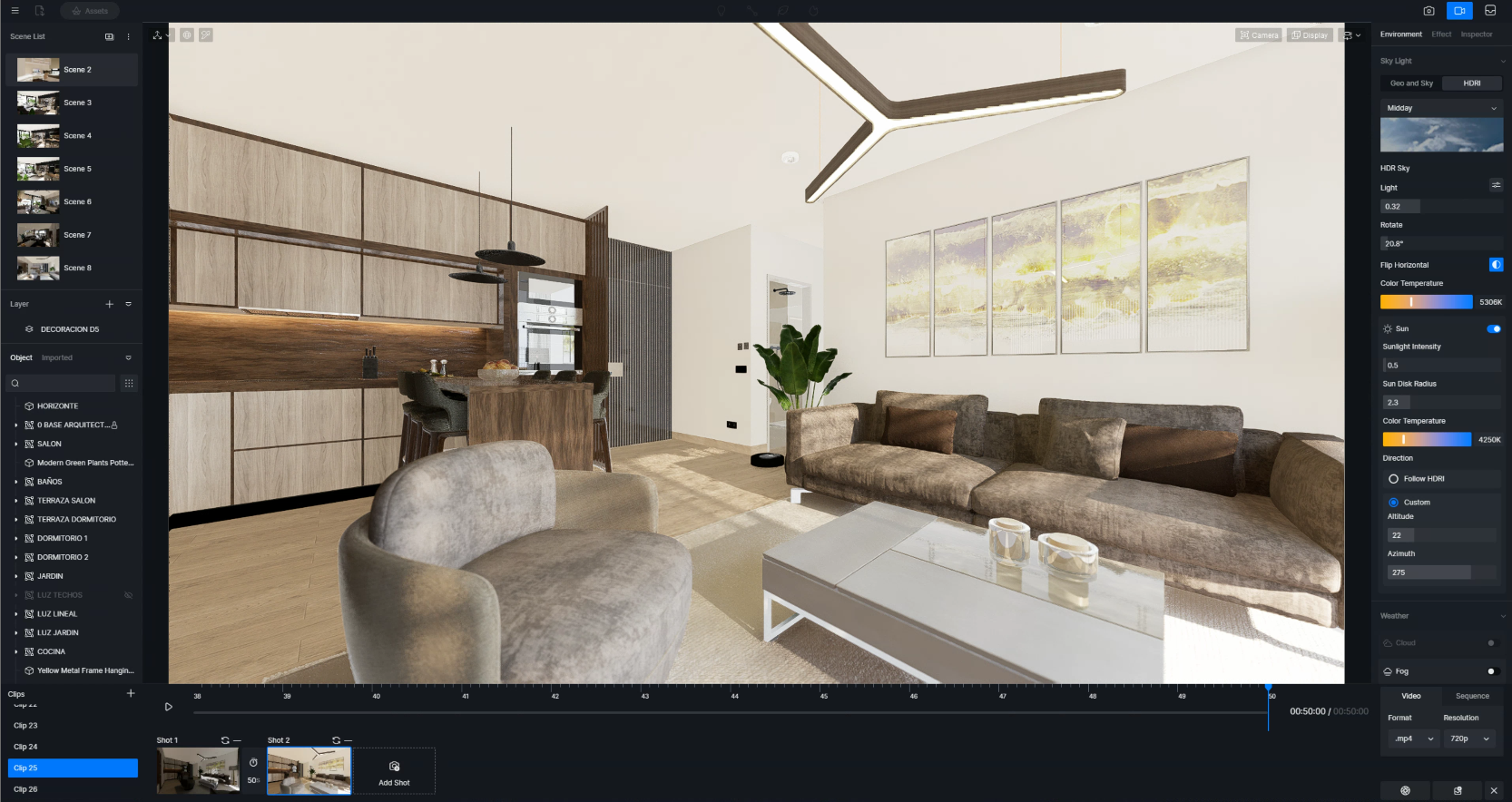

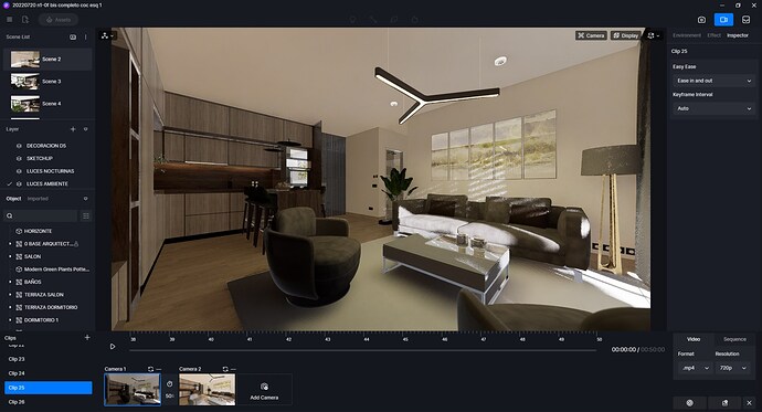

When I run an animated render, in which I have a time-lapse with two different locations of the sun in the first and last frame. The model renders fine and moves smoothly, but the sun rays jump in time as they move. I think it’s better to watch the video I’m attaching in the link.
Kindest regards.
set up: 2 key frames (start and end)
project created in 2.2 and updated to 2.3 ( :grimacing:)
keyframe 1
keyframe 2
Final render with jumping sun
https://www.dropbox.com/s/0p72kx62sprn051/D5_Clip%2025_1_20220816_193655.mp4?dl=0
i just tested it and have the same outcome, it becomes more visible the slower the movement is.
Hello, problem identified and we will fix it soon. Thank you for reporting.
Unfortunately, the new fix will only take effects when making new clips, so it will not be able to correct the clips you have made.
