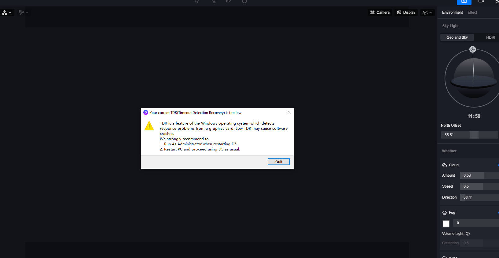

D5 crash every time when i hit render button.
Hello, this error message is about TDR setting in Windows10 system. The solution is easy, and please try them:
- Run D5 Render as administrator(right click the icon->Run as administrator)
- Reboot your computer.
Then the pop-up will not appear again. If the problem remains, feel free to let me know~
