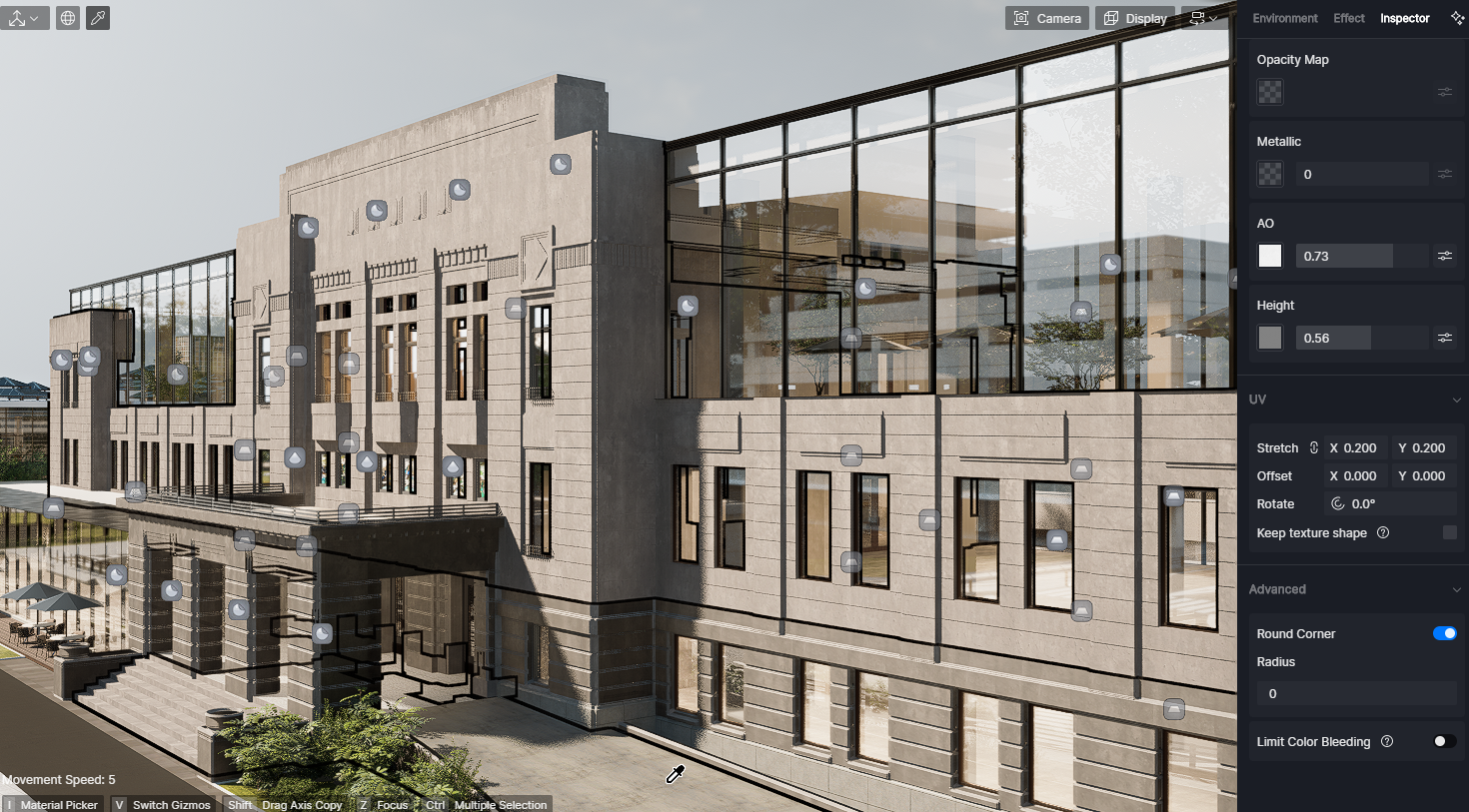

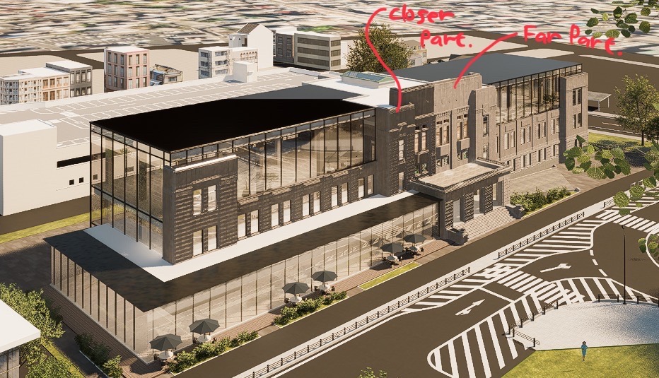

The sunlight illuminating the architectural materials in the viewport becomes darker and misaligned when the camera gets closer
The sunlight illuminating the architectural materials in the viewport becomes darker and misaligned when the camera gets closer. When the camera moves away, the lighting returns to normal. This issue occurs only with a specific model. Even after changing the material, the same problem persists. The issue does not occur with other objects. This problem began when I opened data—which originally had no issues—on a new computer. Could you please let me know how to resolve this?

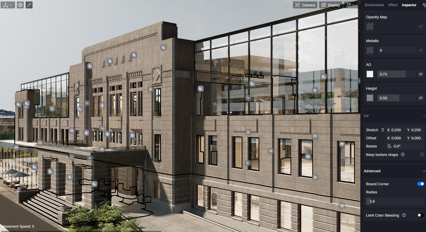

Hi @Clov , Thank you fo testing me my file. I tried the solution you provided, but unfortunately the issue has not been resolved. The same phenomenon occurred even when I opened a different project on a different computer. On another machine, I discovered that the texture becomes distorted when a bevel(ROUND CORNER) is applied to it. Has there been any report of such an issue in the past? In the meantime, we are continuing to consult with a PC specialist on our side. Thank you very much.
Hi @j.asai
Oh that explains why I wasnt able to replicate it. This issue was experienced by RTX 5000 Series with 576.02 Drivers users and has already been fixed in the new 2.11 Update.

Thank you @Clov . My PC is RTX 5080, and I hadn’t updated D5 to the latest version. After updating to 2.11, the issue was resolved! Thank you so much for your dedicated updates and quick response. We truly love D5!
