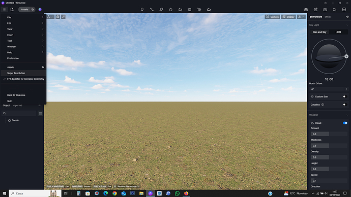

Good evening, have you updated your graphics card?
If you did it then remove Super Resolution and check only FPS

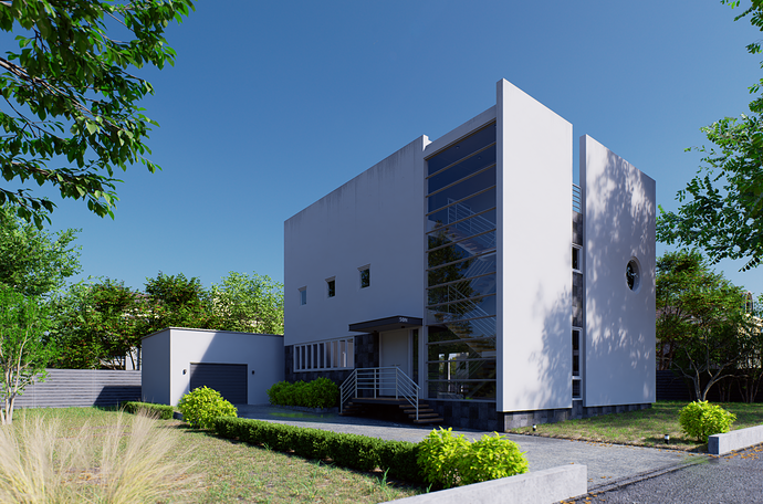

Hi there,
I just tested a Demo file in the 2.8 and 2.9.1 versions. I notice the shadows are lighter in 2.9.1 compared to 2.8, quite the opposite of your claim:smiling_face_with_tear. I rendered this image in 2k and enabled SuperResolution.

Hi @koh980628 @riccardofortelli
Thank you both for your input on this matter. While testing this issue with one of the Demo Scenes (Residence Lawn), I noticed a slight difference in the shadows between the two versions I was using. I will report this issue to my team to determine whether this is normal or a bug in our software. Thank you for your understanding.
