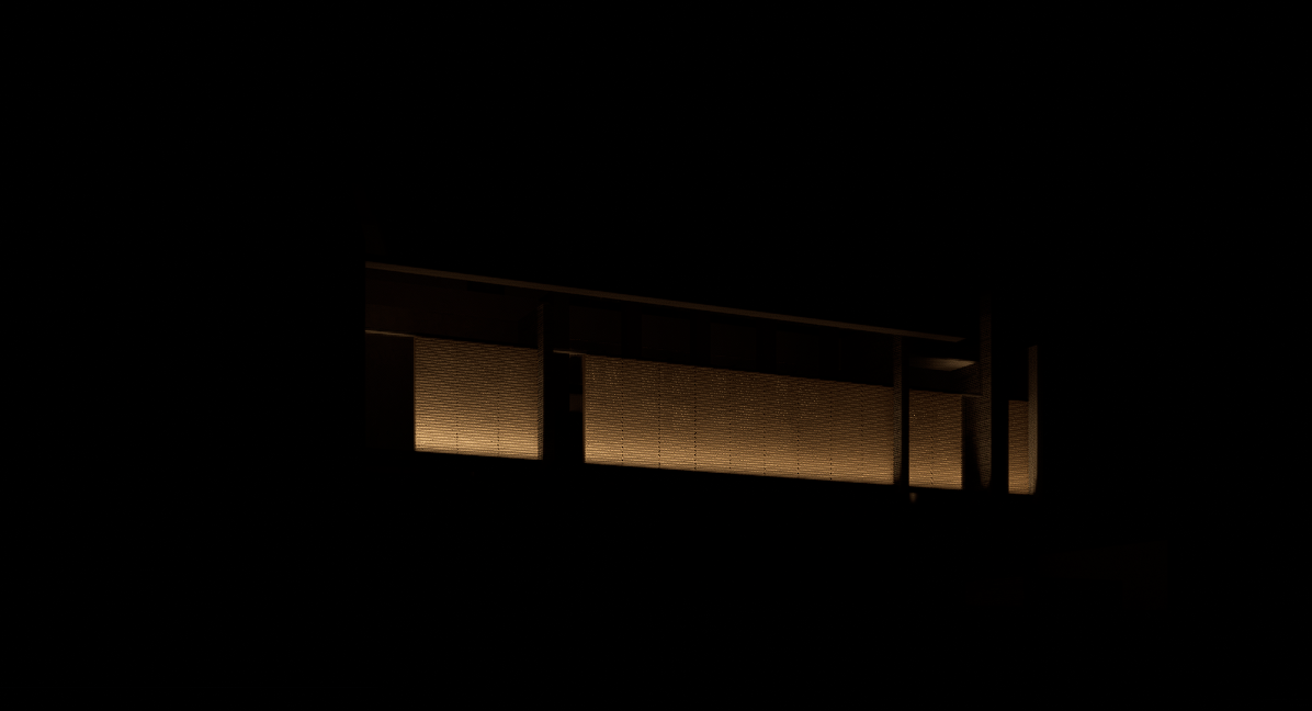

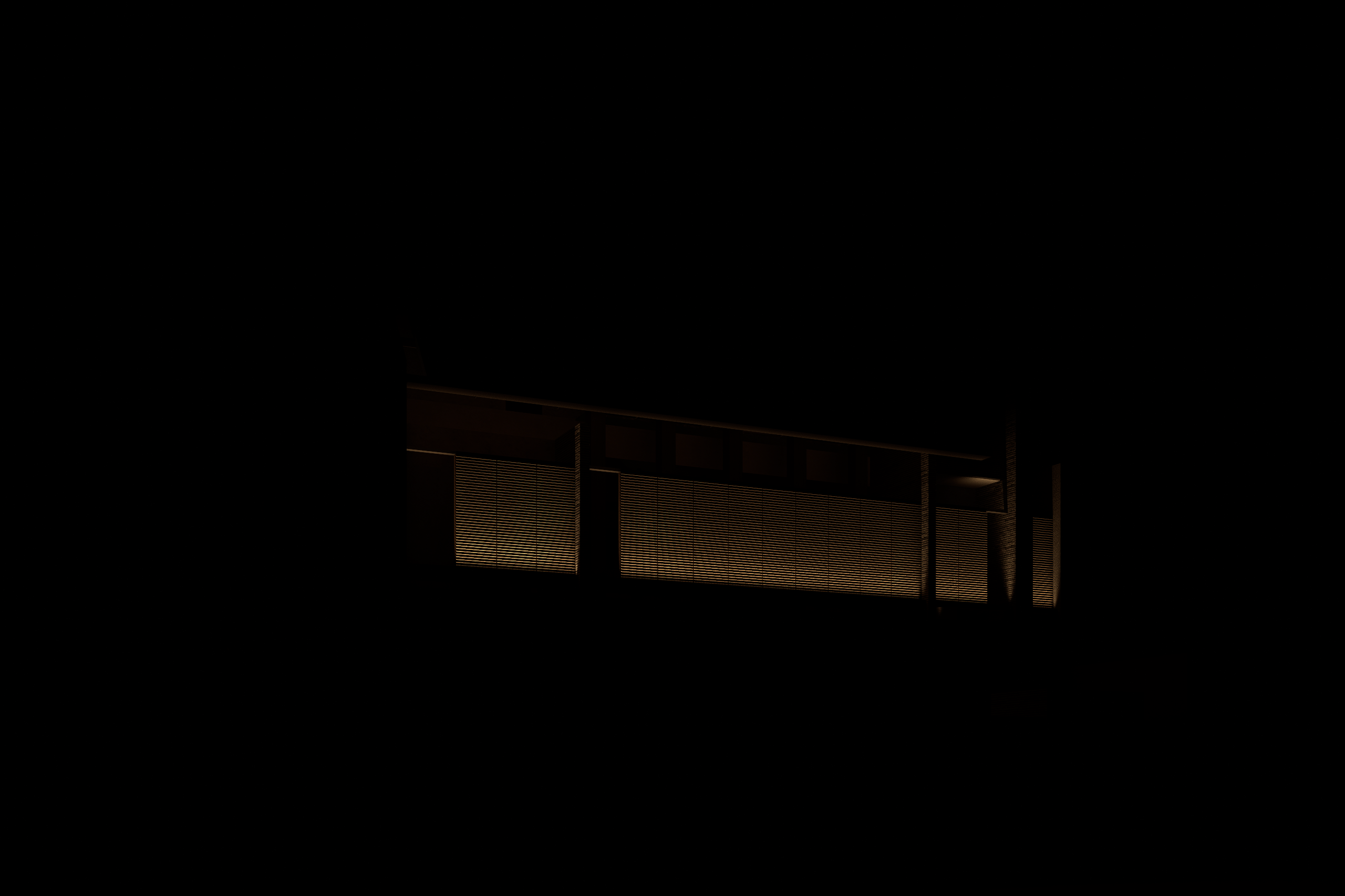

The screen on the D5 is different from the rendering results
HELP
ViewPort D5
rendering
Hi @ahstudio58
Did you activate Path Tracing? Try to disable it or perhaps you can accumulate (Press F4) before rendering since the rendered image is more accurate than the preview image.
Additionally,
  • Is this a clerestory window with lights outside of the building?
  • Try to update your drivers and see if there are any improvements.
  • Which 2.11 build are you using? 2.11.1.0619? Please check
