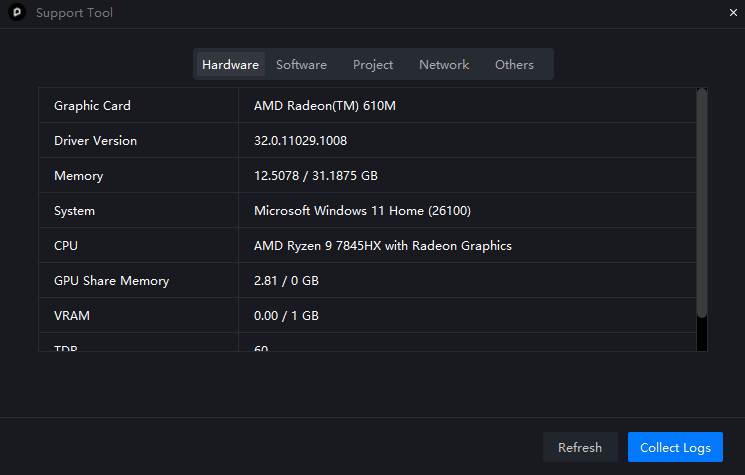

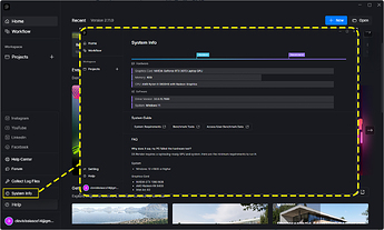

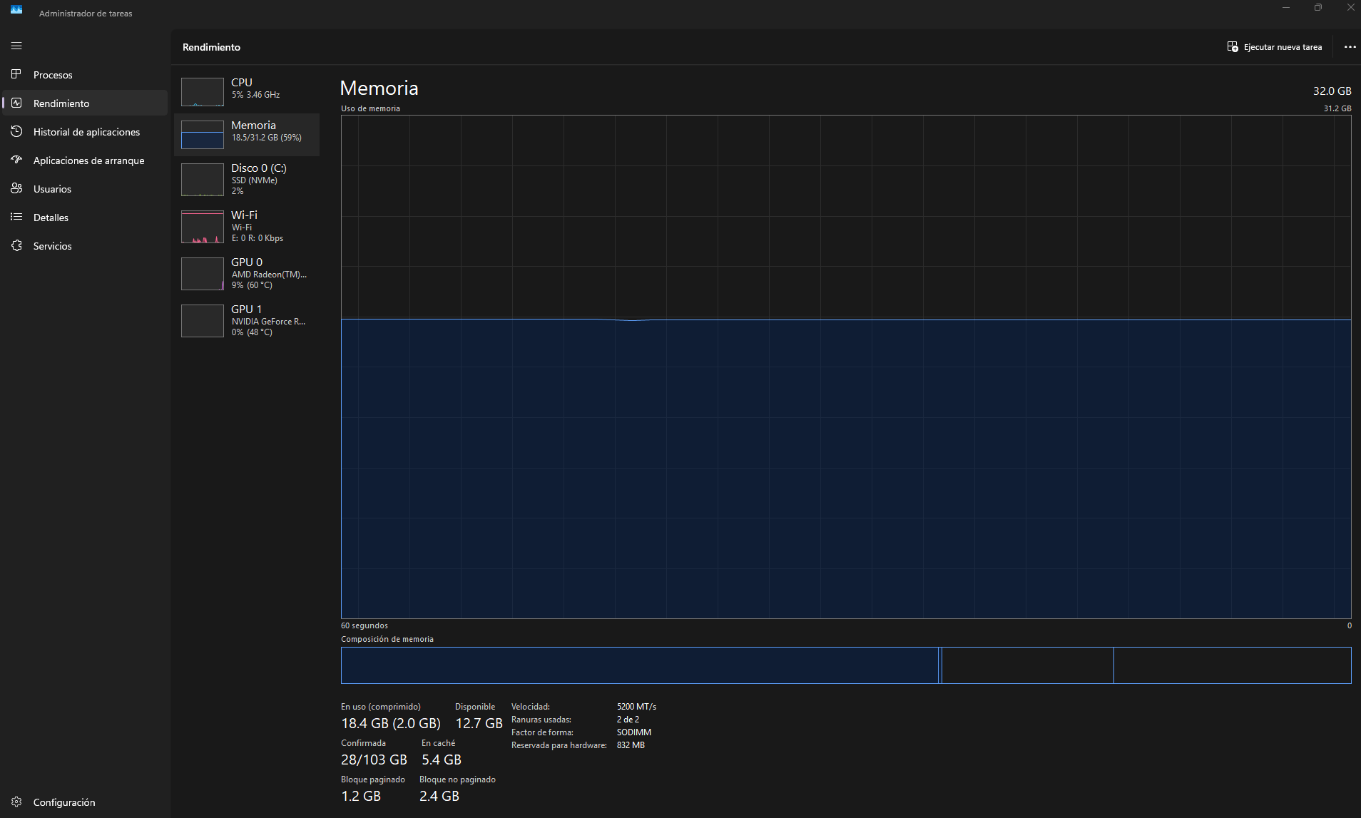

Anyway, please send me the following images:

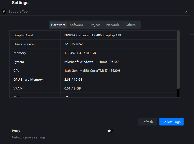

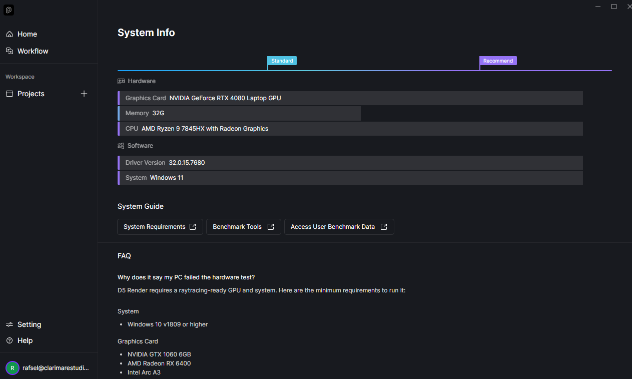

- System Info
- VRAM

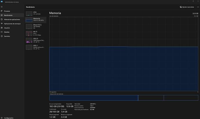

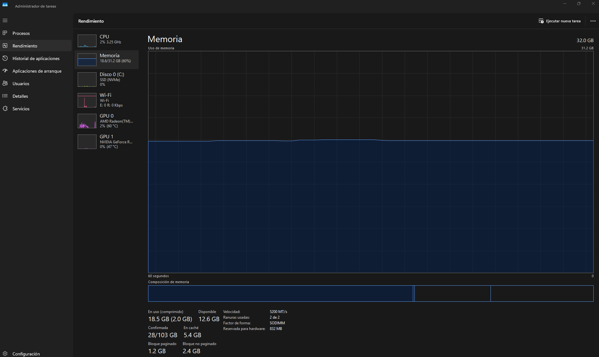

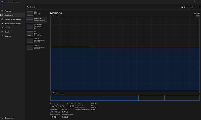

- Memory Speed
Yes, so far it’s only happening with some projects. New files and demo scenes open just fine.

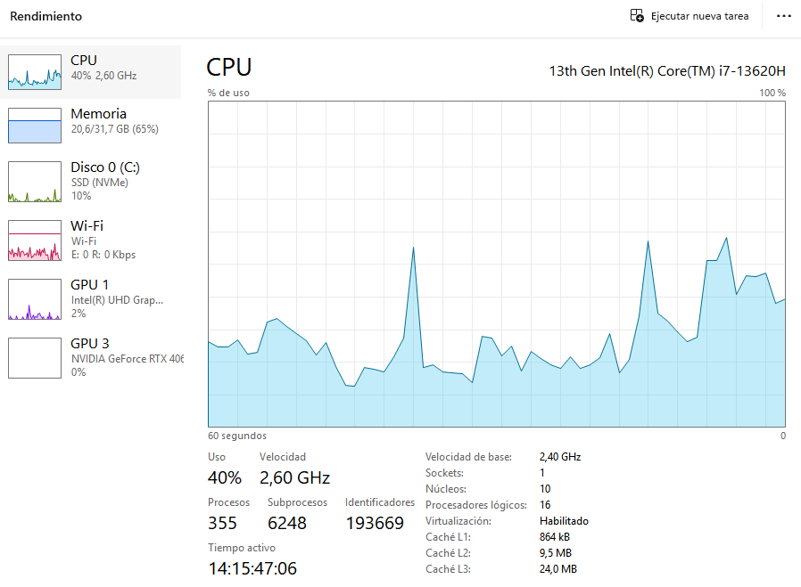

Here are the requested images.

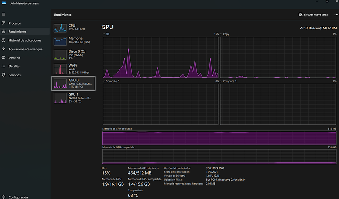

Hi @rafsel

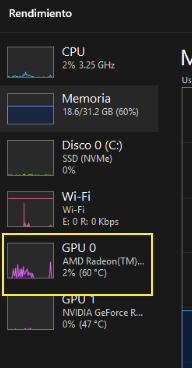

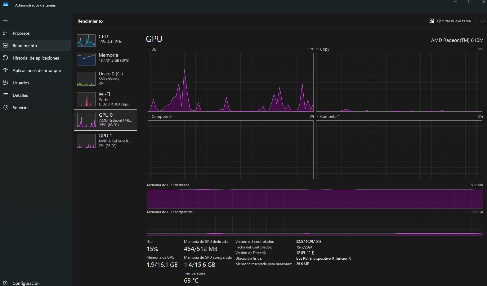

Did you open a D5 File while accessing the VRAM portion? If you have, I think D5 is utilizing your integrated GPU instead of your dedicated GPU.
- Additionally, can I test one of these files that cannot be opened in 2.11? Please send the file link via Direct Message here in the Forum.
- Please also include your log files
Here I’m sending you the VRAM screenshot while trying to open one of the scenes that won’t load. I’ll send you the requested files via direct message.

- Please try opening a D5 file while accessing GPU portion in Task Manager too.
