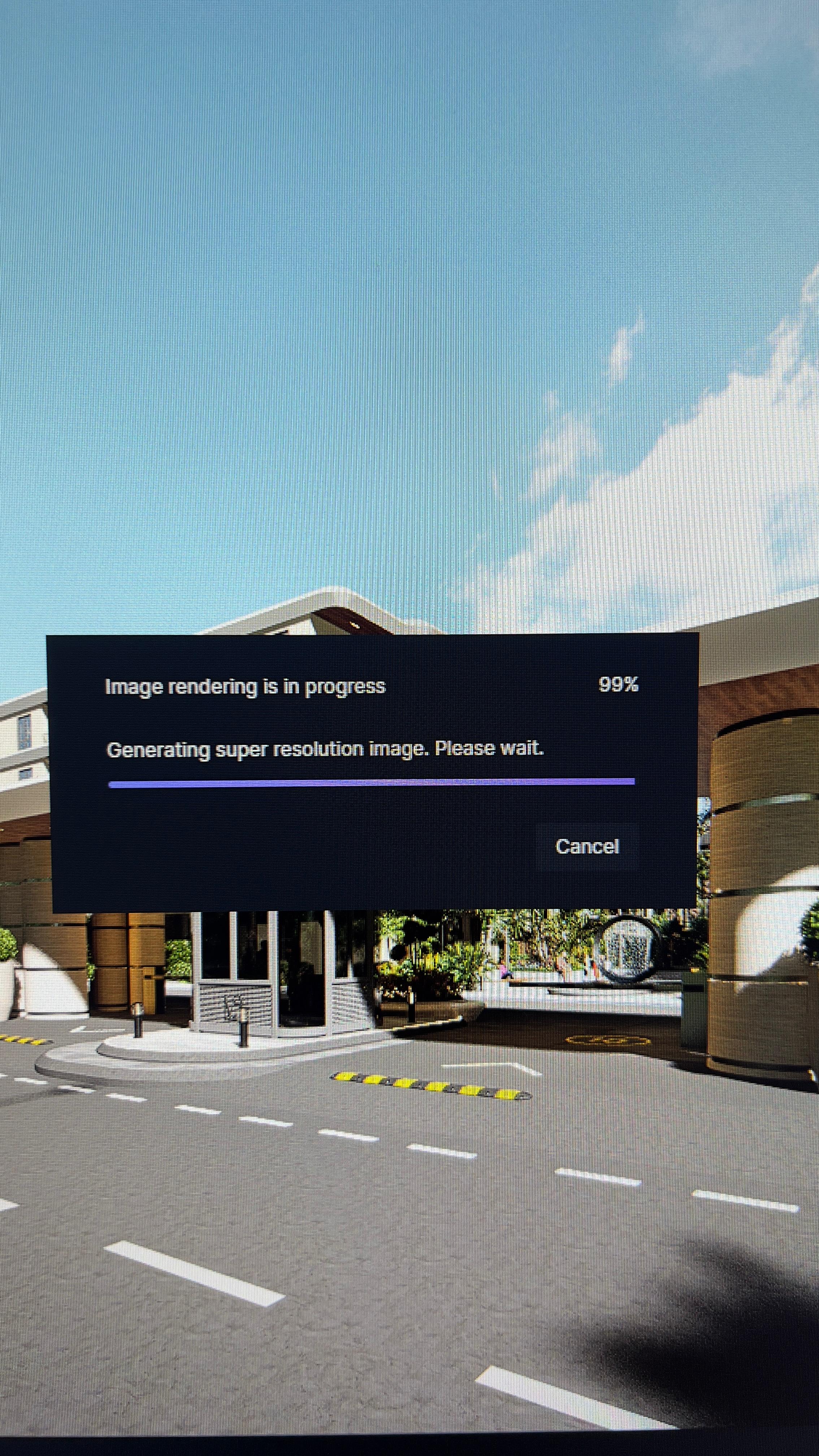

The entire system freezes when the render reaches 99%
My entire workflow is ruined, please help. After resetting the computer, I can only get one or two renders at most, and then it freezes again. All computer hardware drivers are up to date.

Hello. I’m using the latest version of D5 and updating the BIOS solved the problem. Thank you for your feedback.
