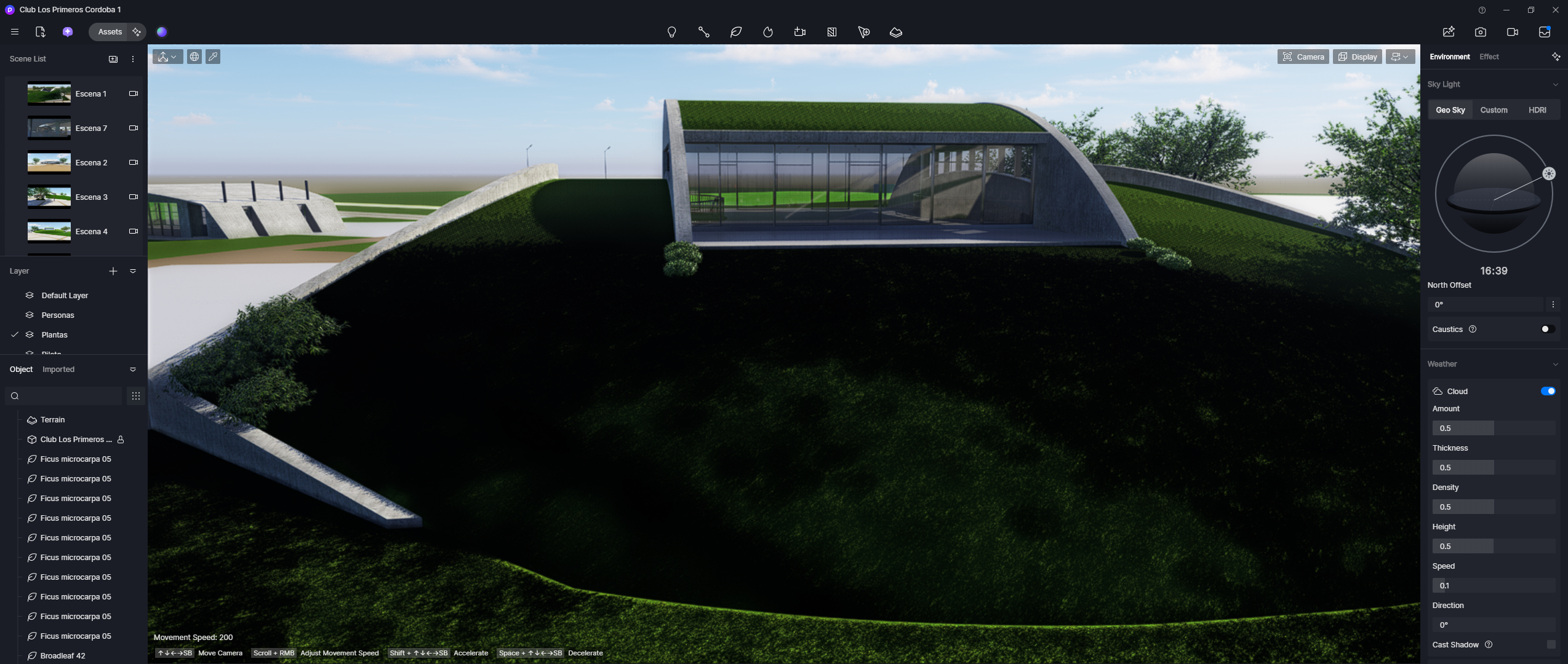

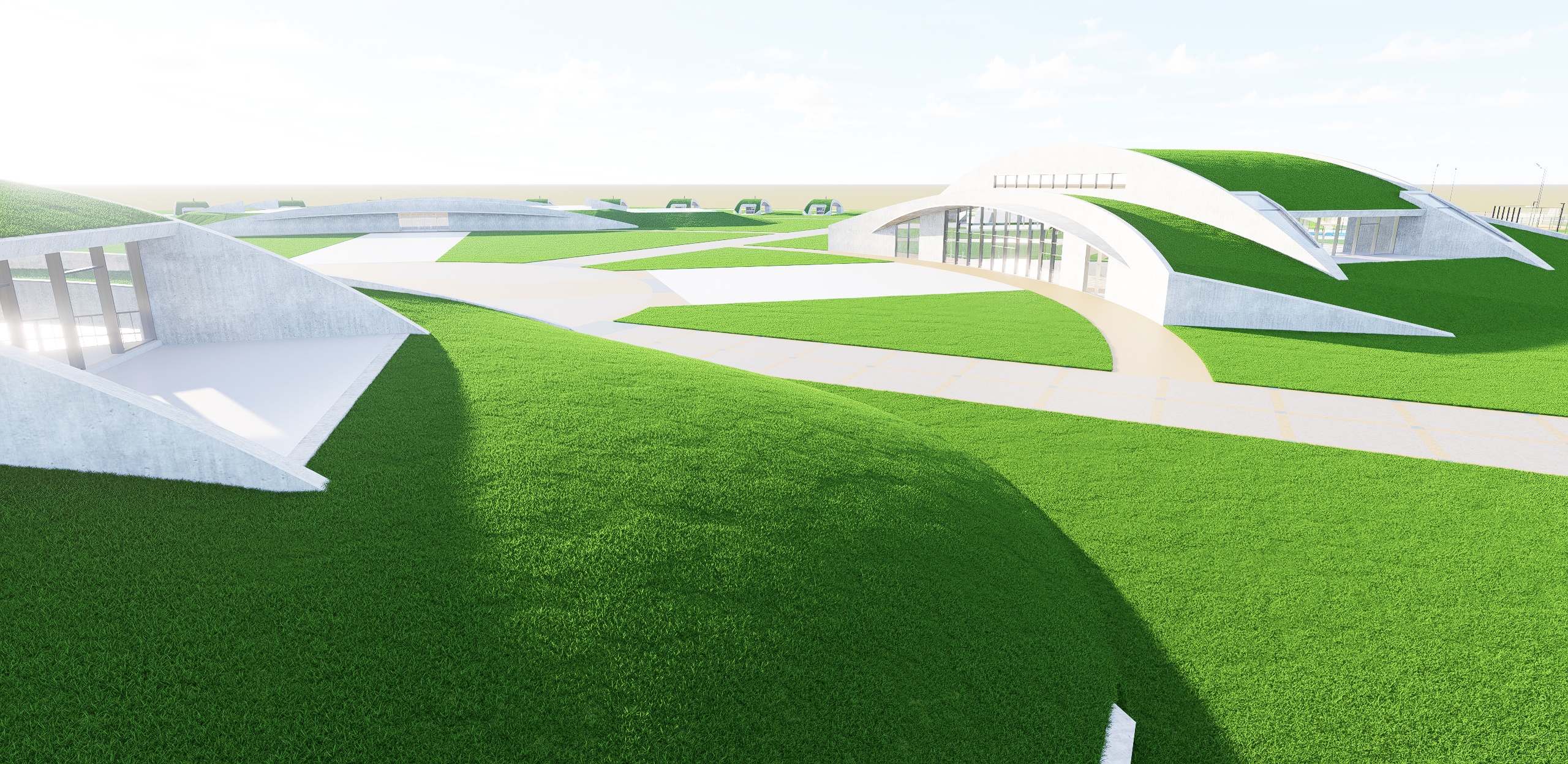

The desktop screen looks bad, and the image results are incorrect
Hello again!!! Version 2.11 is running terribly on my computer.
The desktop screen looks bad, and the image results are incorrect.
First, I uploaded the desktop screen images and the results to version 2.10, and then to version 2.11.
Before installing the new version, I deleted everything previously installed.
I deleted all traces of D5 render from the PC.
I also re-created the files from scratch for each version.
I did this to make sure there was no possibility of inheriting any problems from previous versions.
And 2.11 doesn’t work properly.

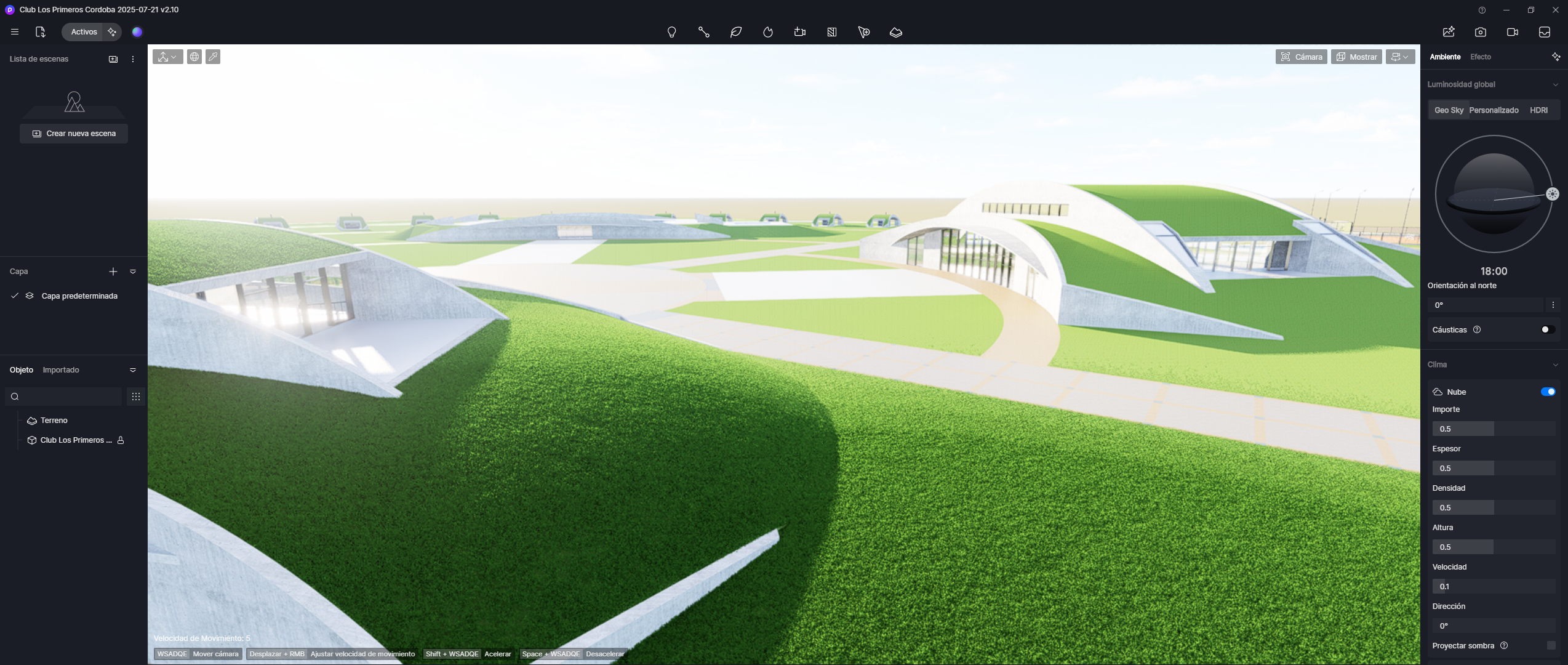

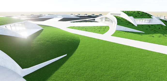

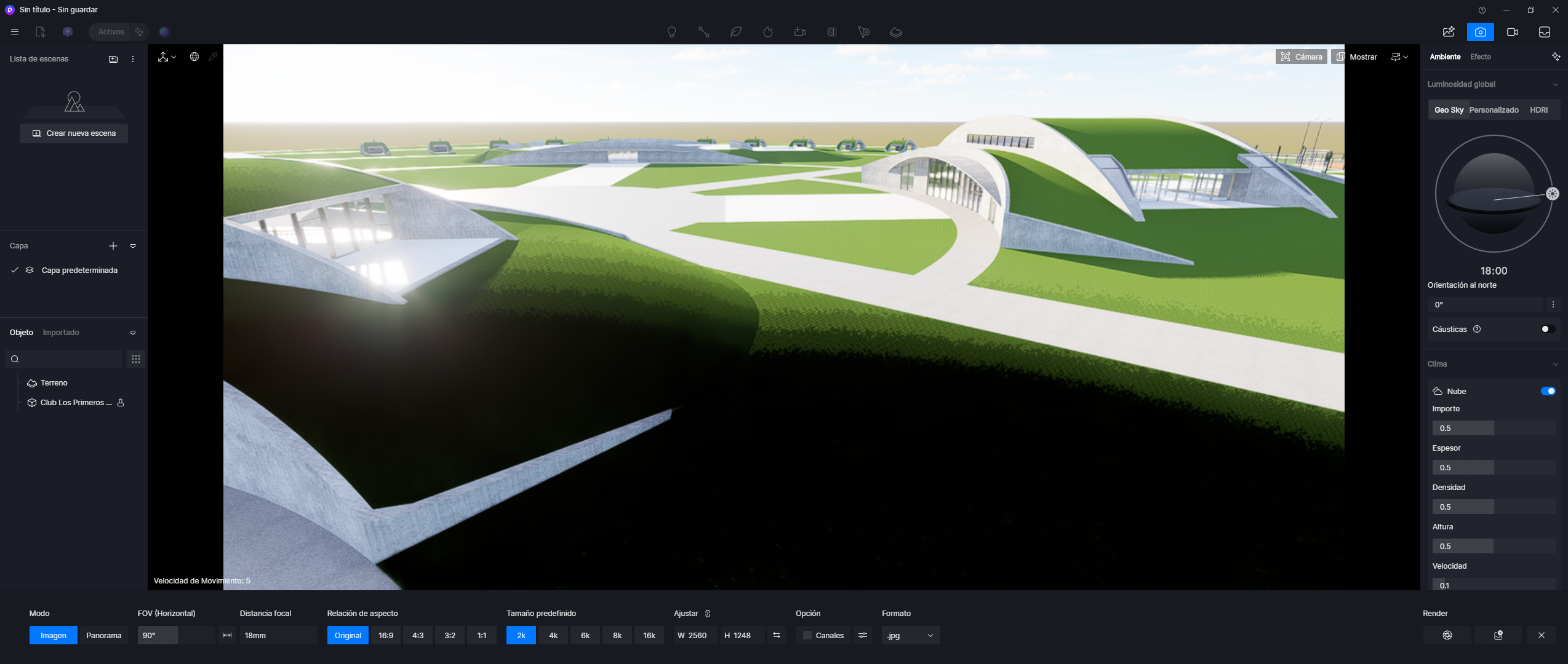

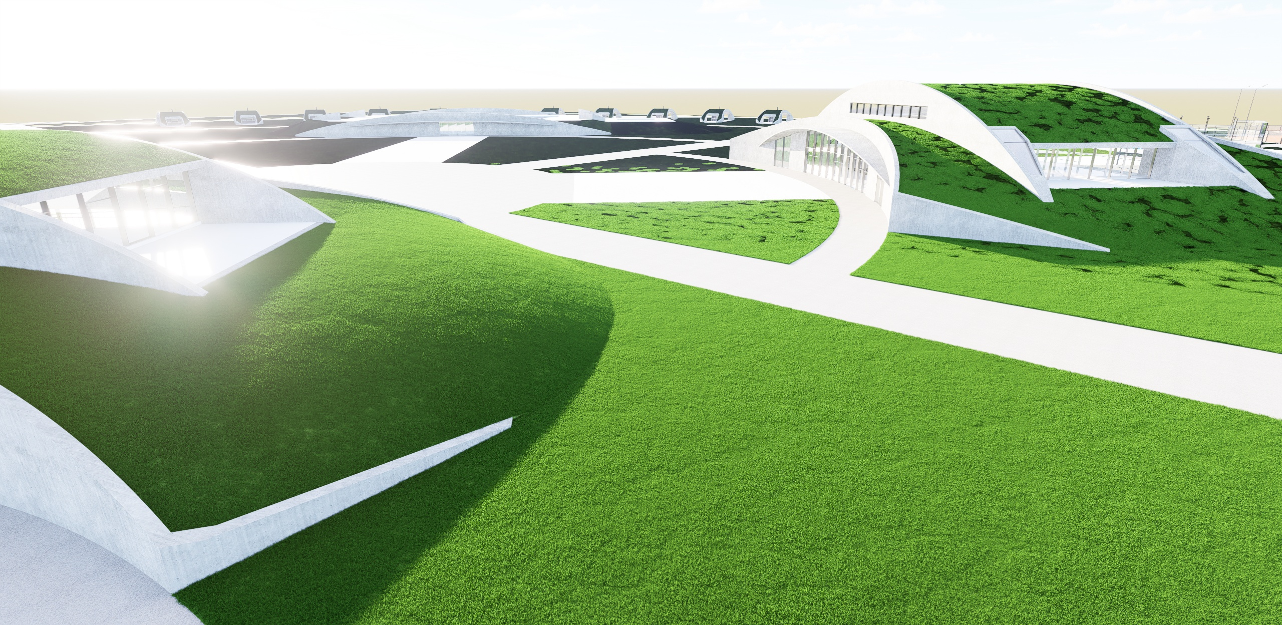

Version 2.10
Version 2:11

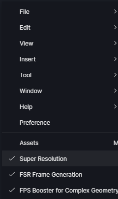

  • Does disabling any of these settings (Super Resolution, FSR Frame Generation, and FPS Booster for Complex Geometry) alleviate this issue?
Please send us this specific file and generate a log file for us.
Hi, Clov

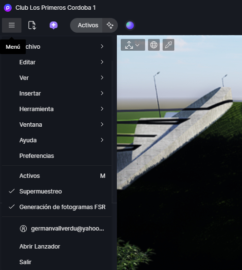

In version 2.11 of my D5 Render, the menu doesn’t exist (FPS Booster for Complex Geometry).
I just reinstalled everything.
My menu looks like this.
After reinstalling everything, the image on the desktop screen still looks this bad.
