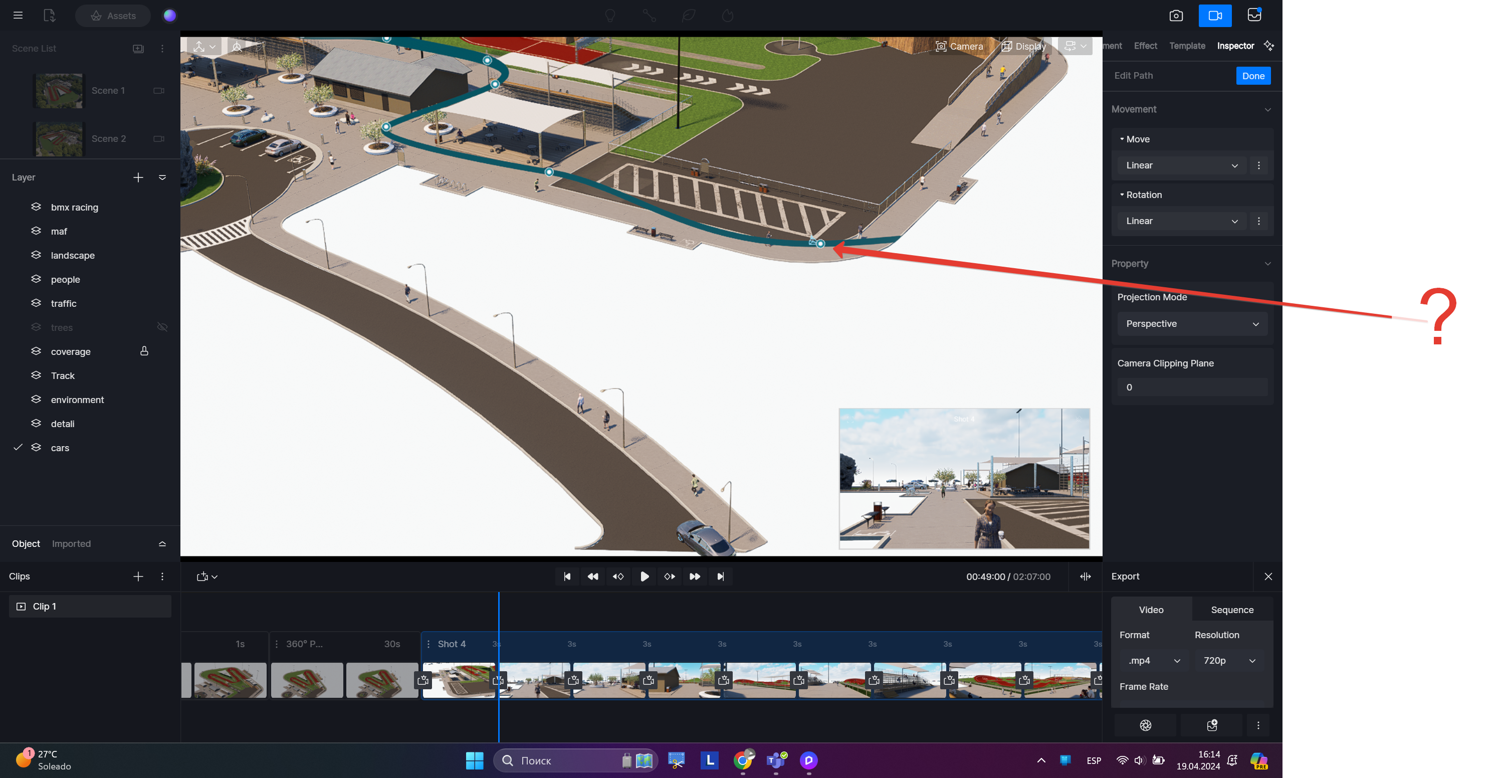

why can’t I select the camera and change its path as shown in your video? she just doesn’t shave!

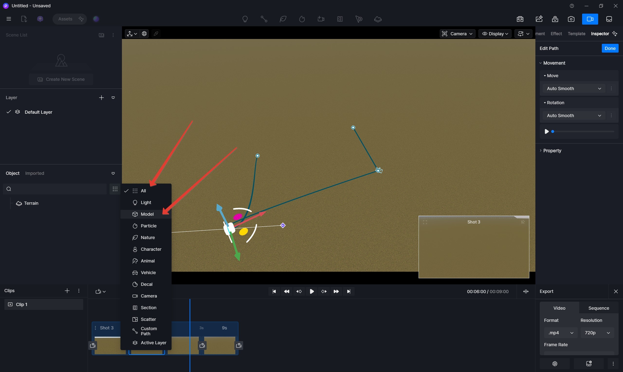

It is the filter for objects, not layers
That has to be in “All” and not in any other
When it is like this, yes you can edit the camera path

Hi! When working with the camera path, make sure your object filter is set correctly.
It should be either “All” or “Model” (as shown in the screenshot).
If a different filter is active, you won’t be able to select all path points or edit the spline properly
yes, it is as shown on ALL or Model but this doesn`t change anything
