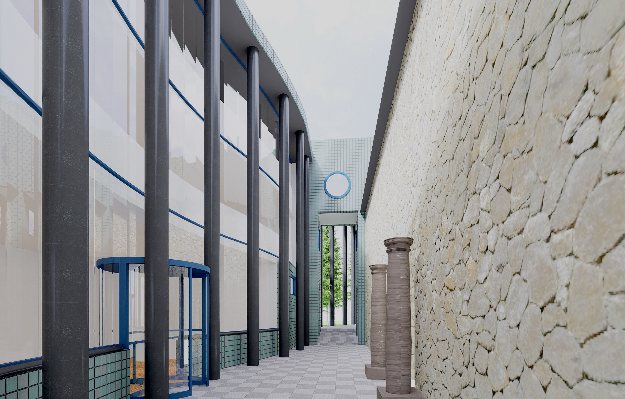

Please review the attached image. You may need to zoom in on a smaller screen to see the stairs better.
The model is from REVIT. The stairs and the pavement are the same material in the original file. So, when a texture is applied to either element, it spreads to all others of the same material.
Do I need to assign different material to each of these elements in REVIT?
Further, how does one align stone from the riser (vertical face of the stair) and the run (horizontal stepping surface)?
Thanks for any advice.
