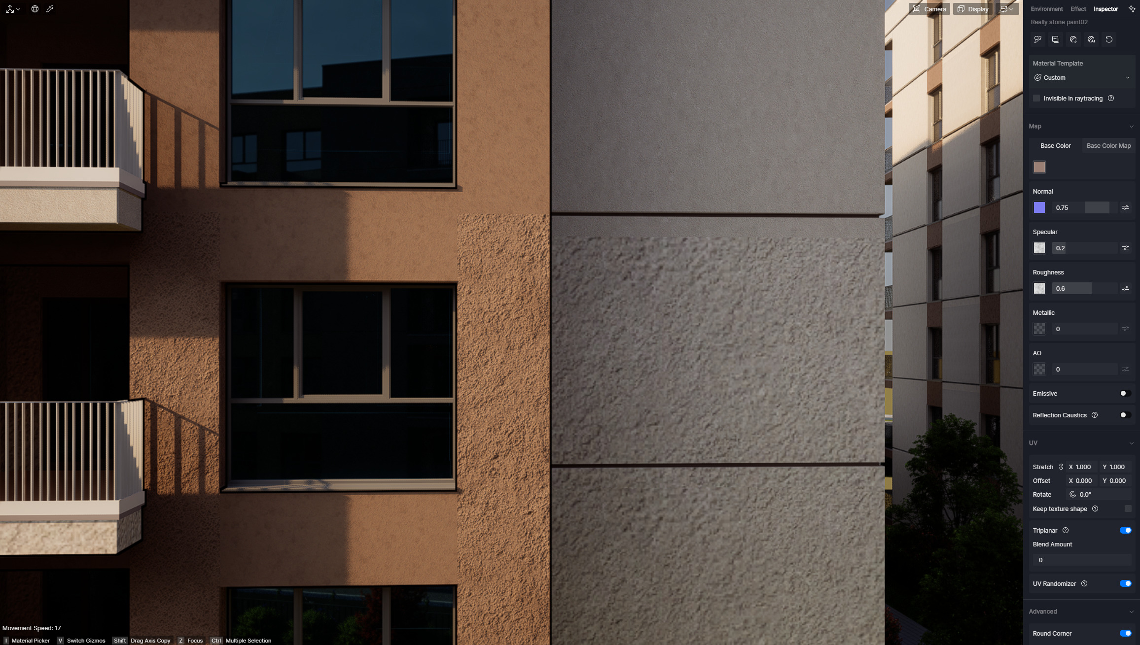

I use SketchUp and D5 Render. In the D5 Render interface, the texture mapping size appears inconsistent in different areas of the model. I have taken a screenshot showing this issue. As you can see in the screenshot, the Triplanar option is active. How can I fix this?

However, there are cases where texture sizes differ within SketchUp. Since the project is very large, it’s not possible for me to manually match the texture sizes inside SketchUp. I expect D5 Render to treat all surfaces consistently regarding texture scaling. Is this possible? Because with the software I used before D5 Render, I was able to handle this easily. In general, I work on projects covering millions of square meters, and texture management seems like it might become a problem

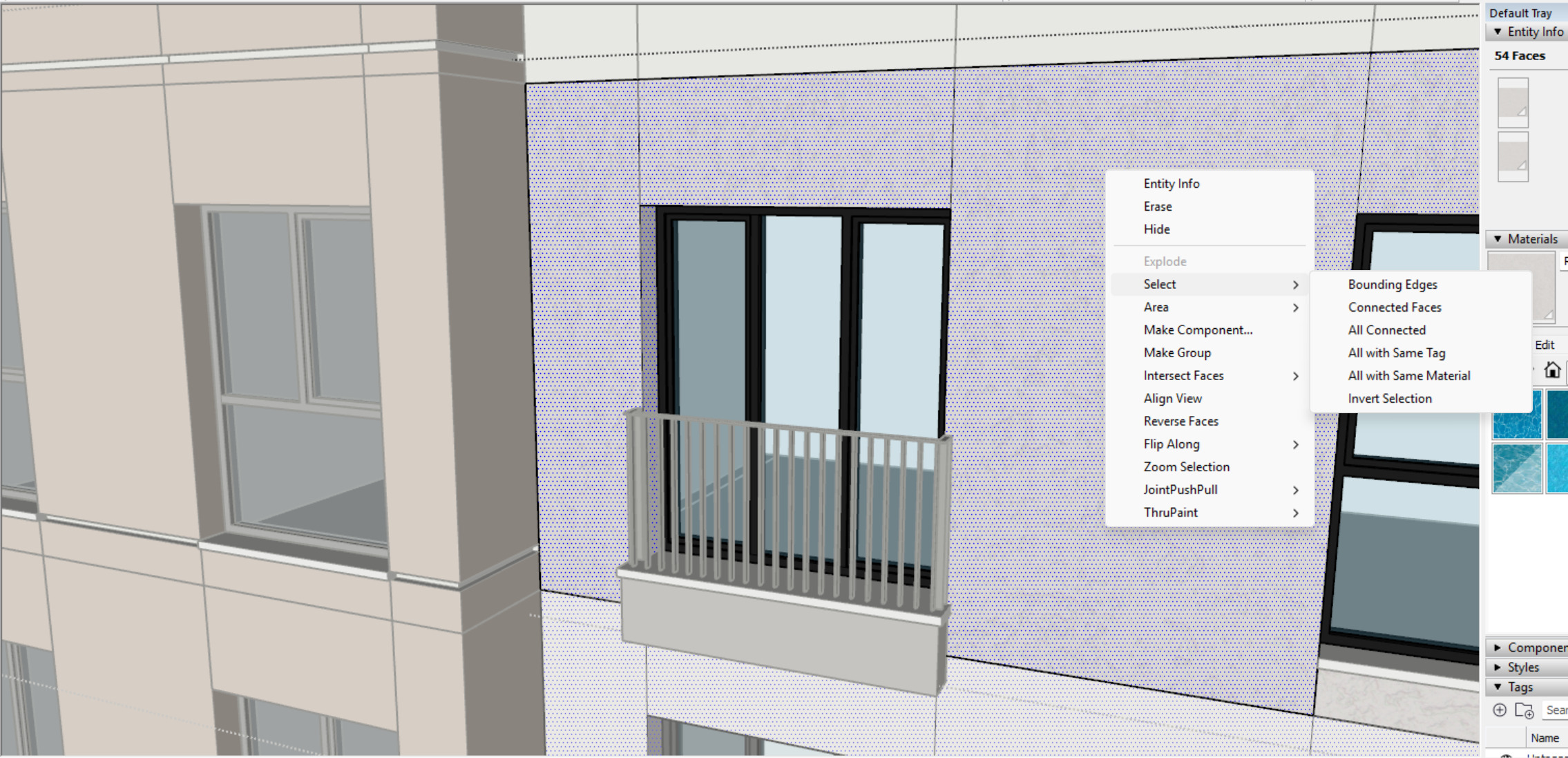

We’ve reviewed your file. D5 Render reads the material scale as defined in SketchUp. To resolve any unexpected mapping differences, please ensure the material scales are set correctly and consistently within your SketchUp project.
If this is unintentional, it might be a bug within SketchUp, or perhaps this is also within SketchUp’s expectation because they are grouped within a group (an inception of groups)
You can either:
- Explode this portion of the model until they have the same texture scale
- Or right click on the surface (go inside the groups) > Select > All with the same material > Reapply the material
